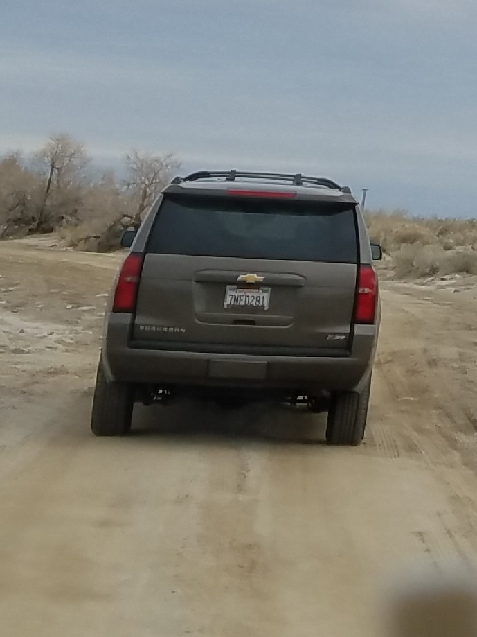

Folks, the roof is the problem. I bought some hard rubber stock from MMC and fabbed up some spacers to wedge between my roof rack and roof and the problem disappeared.  Take off the spacers and it comes right back.  My 'burban is awesome now with the spacers in place.
These trucks are made of extremely thin sheetmetal.  The roof, short of welding it to the bows, will just pull itself free.  You need to hold it down by some means.  I suppose you could rivet it to the bows but you'd need to seal it very well.  Maybe one could bedliner the roof to stiffen it if they wanted.
Anyway, if anyone has this issue, you have two choices.  Make GM buy it back or find a way to hold the roof down.  All the tire combos, etc... might make it a bit better, but rest assured you will find a road or speed condition that gets the roof flapping.  Hold the roof down, you can run all kinds of tires, etc... just like any other normal vehicle, and enjoy them.

Very interesting. Can you post pictures of these spacers and where you put them?

Frank, I ordered two cross bars so I can try your fix.  Can you provide a picture of the fabricated spacers and/or a link to the hard rubber stock you bought?

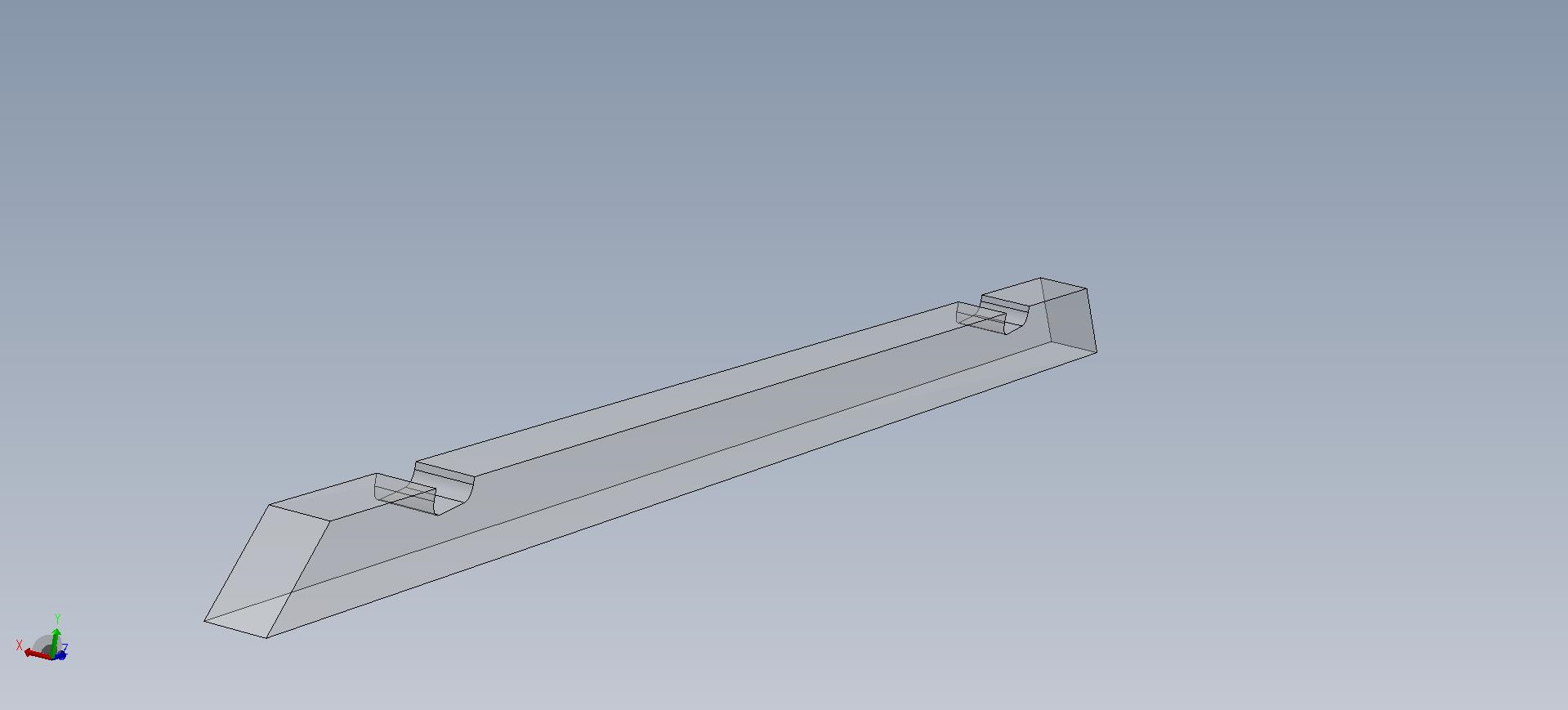

I did model them in SolidWorks but I have not built to the model. I just made them to-fit with my band saw.
So my prototypes are urethane bar stock.  I used (2) 1.5" square pieces (24" length) glued together but going forward I would use something harder.  Maybe something like this...  https://www.mcmaster.com/#=1ava2d9
I also suspect going to 36" will help as well.  I use 2" wide weather stripping between the bars and roof itself.
I drilled holes to get the radii and then cut into them tangentially with the band saw to try to mimic the shape of the roof racks.  I did have to purchase the roof racks separately since my truck did not come with them.
