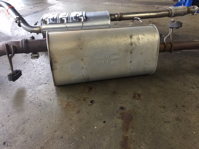

Has anybody tried replacing they're exhaust?

We ordered 5 dampers and installed 4 like other have.
I realize that other that had this done had a short wheel base. So it yiu look at FogDucker's photos, his muffler is immediately after the mesh joint. So his 2nd damper is right before the muffler.
On mine being an XL, I had a long stretch of pipe between the mesh joint and the miffler.
We placed the second damper in the middle of that pipe.
My booming is significantly reduced. But not completely gone. I'd say about 85% gone.
I'd attribute this to the 6.2L XL exhaust being much longer and larger than the short base 6.2L or the 5.3L like Ozzii has.
So when I return for an oil change, we'll put the 5th one on.
We're just going to slide the #2 damper in the middle of the pipe to the left and put it again the muffler and put anot her damper directly after the mesh.

2/2 - Got call from dealership that the exhaust has been replaced and the technician said 99.9% of the buffering was gone. Went to pickup the Suburban, drove it home. Not only is the booming/buffering still there now the whole exhaust rattles!!! Unreal.
So now I have to go back to the dealership and fix the main issue - the booming/buffering noise - but also have to find out why the exhaust now rattles.
2/3 - Got call late today - exhaust rattle fixed. Engine motor mounts were replaced but did not help. They are now going to add foam insulation into roof and look at roof bows. Say should be done by tomorrow or early Monday. Chevrolet said they would not pay for road force balance so I went ahead and paid to have that done. Results came back that all 4 rims were in spec. Tech said he will show the before and after results to me when I pickup vehicle. So at this point the exhaust has been replaced, the motor mounts replaced and tires road force balanced. I'm following what I have to here with what Chevrolet is telling me but not sure what would be left to do if roof work does not fix issue....
One thing dealership told me is that the exhaust is different in design. Does anyone know what changed from '16 model to '17?
Today I took my 2015 Yukon Xl for a drive with the service manager. In the last week it has received the PIT5318C roof bow work and it received the PIT5404 exhaust system replacement. The service manager commented that the buffeting did not really improve until after the exhaust change. The difference in the exhaust is the valve for V4 used to be behind the muffler and with the revision it was moved to before the muffler. I guess this is logical since that would help deal with the change in tone when you go into V4 mode. There is still a vibration that will be measured with the PICO (sp?) meter to help isolate, but he acknowledged its presence and wants to use the equipment to hone in on the source. I have had my rear tires RFB 2X since October.post-19164-0-73605000-1486325564_thumb.jpg
