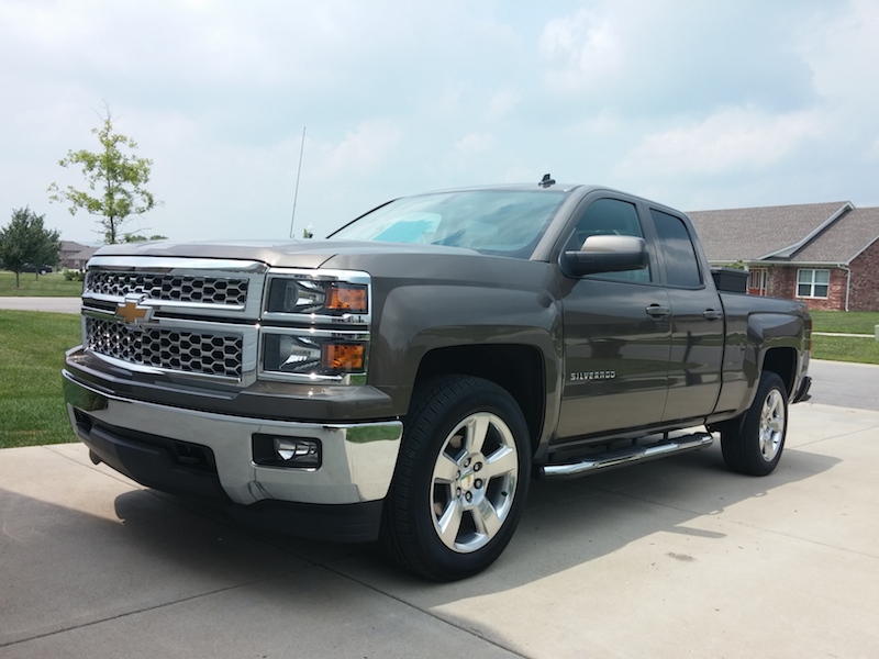

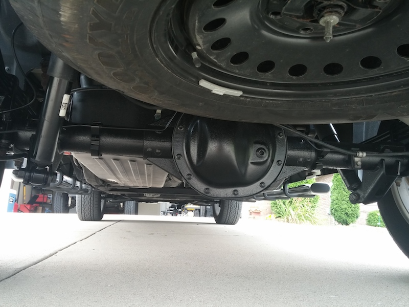

Picked up the truck from dealer today. I'm very impressed with the job they did on the frame. It appears that the entire frame was done, not just the bad spots. They also coated the rear axle, and the truck been detailed when I picked it up.

That looks really good! I'm phoning tomorrow about the same issue on my truck. Do you have a copy of the service report saying what all they did or if they just followed the TSB?
How do you know they did the 2 step TSB procedure if they covered it all with undercoating? I've never known a dealer to give something free unless it suits them.
