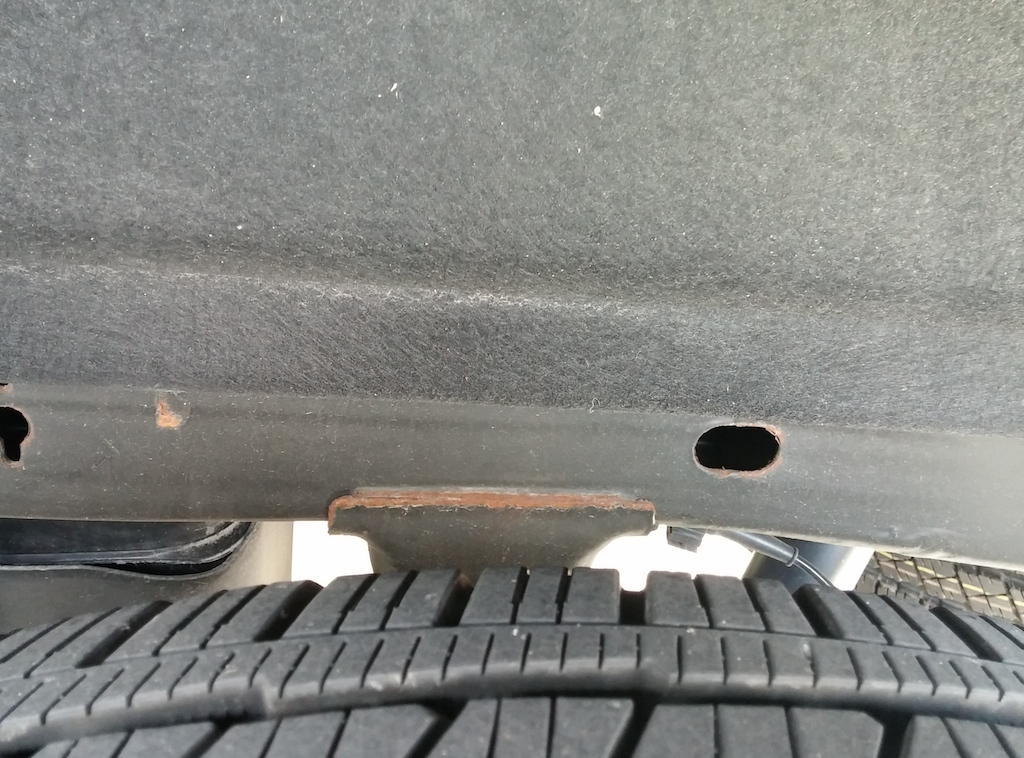

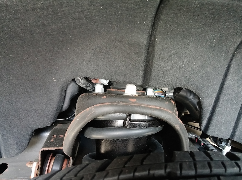

Hello,
I am dropping my truck off on Monday to have the frame rust TSB fix done. It has been a couple of weeks waiting for the dealership to get the products ordered in they need to re-coat the frame. The TSB lists what they are, but it is not just 3M undercoating, it is a 2 step process that is supposed to be almost exactly like the original coating. I saw one member's truck on here (topaz blue) looked like they removed the truckbed, but his looked awesome. Hope mine turns out as well.
In addition to the TSB fix, the service manager says he would like to undercoat my truck free of charge. I assume this is sprayed on (probably and extra thing that was offered when I bought the truck). He said they would do all the steel brake lines and spray under the box? I know very little about this. I definitely don't want a bunch of goop sprayed all over everything making it difficult to service suspension parts etc down the road. Does this have to be maintained or reapplied in the future?
My truck is not the worst that I have seen, but it is bad enough to bother me when I see it. So here it goes! Ill post some after pics after it has been done.
Also advice on what to do about this undercoating business would be much appreciated.
