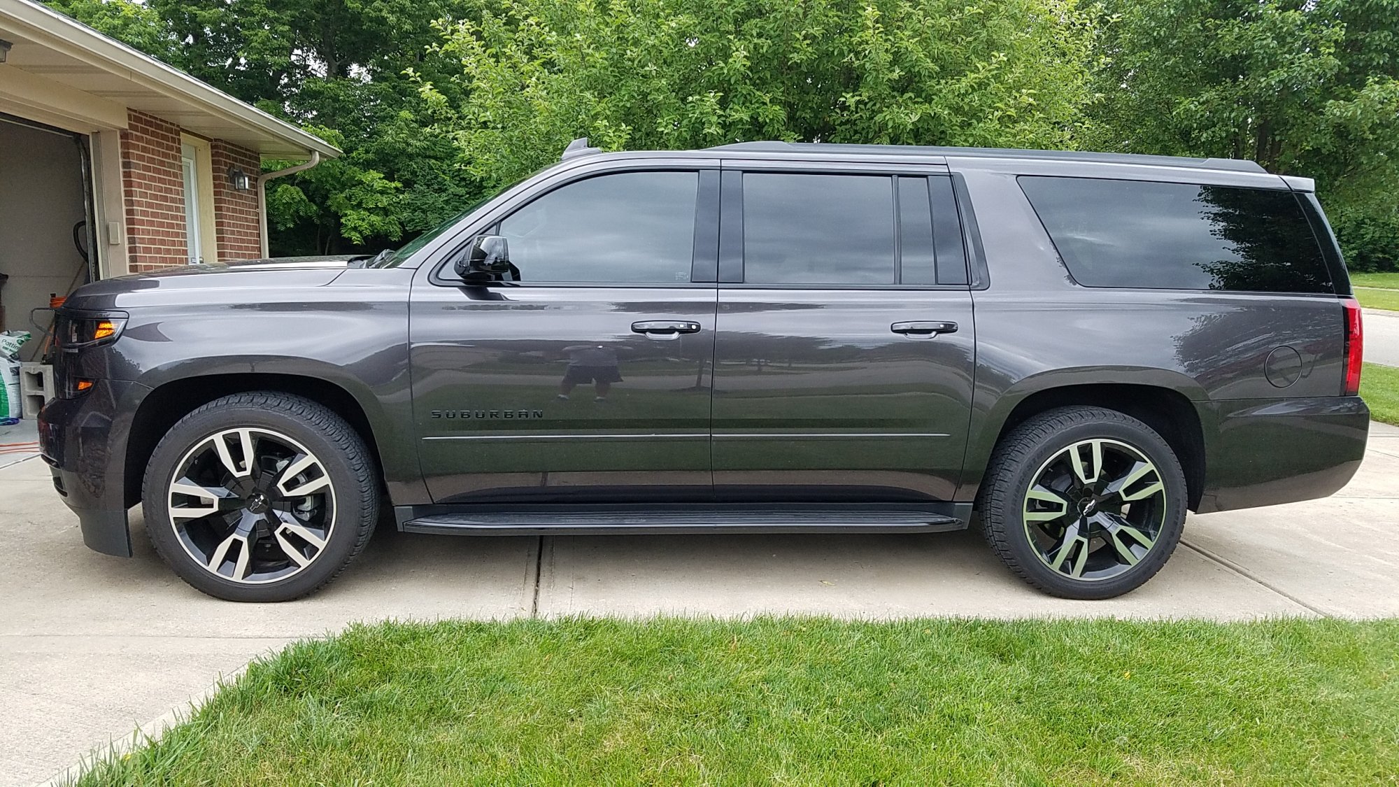

I guess I forgot to report back. This was my outcome. I cut the front air damn to regain a couple inches after lowering
Looks great!  RST Suburban. :thumbs:   What kit?  Did you install yourself?
I used https://tbssowners.com/store/index.php?act=viewProd&productId=609 and I did install myself. Wasnt hard at all. Just went slow on the front. Overall pleased. I was worried about being too low but I dont feel its near my "too low" status and I can clear everything so far and havent towed yet but dont see an issue since I felt with my utility trailer the angle was too high anyways. Again I trimmed the front air damn to avoid any curbs and parking bump stops
