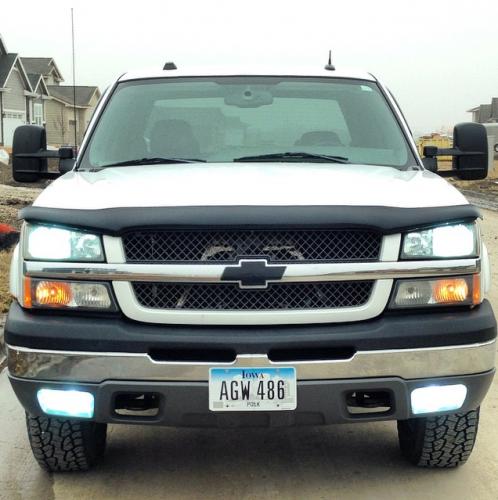

i didn't like how the tow mirrors curve up on my 04 silverado so i decided to level em i think they look way better getting a roof light bar in 2 weeks and a ranch hand grill guard post-136092-0-00112200-1419795466_thumb.jpg
LOL! What did you do to level them? Just space out the top mounts? I never did put them on my 03 2500hd because of that look and just used the slide on ones when towing. Figured it would only look that way when I had them on and the permanent ones would always be that way!
on the mirror theirs a cap where the tow mirror come out and their should be 4 bolts you loosen the bottoms ones not all the way and the top ones you would take out and put a couple washers. The washers were to hard so i put nuts on it. then you pull the tow mirror out and put a little level on it and if you like it you tighten the bolts and you have to cut a little bit off the cap the put it back on. you will think their unleveled defiantly from the inside but its not you will get use to it.
Cool. I just didnt want to spend the money on the mirrors without knowing that they couldnt be manipulated level some how.. Never gave it much thought apparently.. Good for you!
I didn't care that the were leveled up I just was bored and thought a way to level em so I did

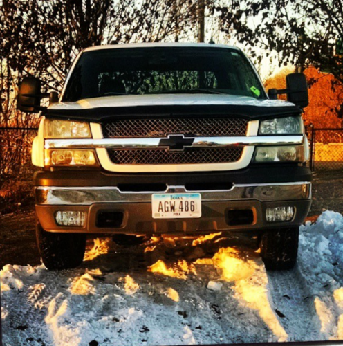

Not sure what I'm missing here. How about a "before" pic?

i was going threw instagram and i found a good pic before i leveled em
