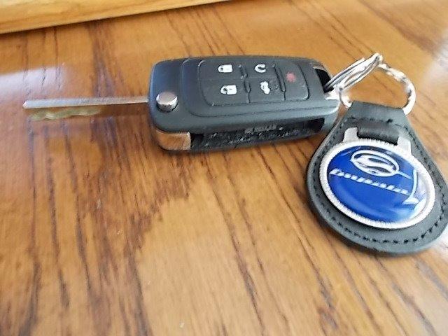

OP's problem of unwillingness to carry the remote fob will soon be solved. Just fobs, not keys and fobs are the future. GM Trucks have already migrated from double sided machine cut keys to the laser cut blades and the next step already on most newer vehicles is one piece switchblade keyfobs with the key blade spring loaded into the fob, like my Impala or optional keyless entry. Even "keyless entry keyfobs" like my Malibu use a fob containing a hidden blade for emergency entry to the hidden keylock in case the fob battery dies.
Car keys are an endangered species and evolution's lesson is adapt or die, so once the remainder of the newer models follow suit, it will be either carry some type of fob.......the switchblade fob, a keyless entry fob or call a taxi.

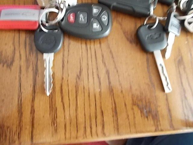

GM's uses a mechanical only keylock in the driver's door. There is no transponder like the one in the ignition lock that "reads" a chip in the key to deactivate the system. The Chevy and GMC truck keys do not have a chip in their keys, They are laser cut mechanical keys only, the FOB deactivates the alarm so it cannot be activated or deactivated with a key, operates the same with GM's older systems like my Traverse which use a traditional cut key with a chip, but also lacks a transponder in the driver's door to read the chip.
GM keys with a "chip" inside contain a cross within a circle symbol at the base of the key; GM keys without do not.
