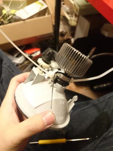

They have three pegs, in this picture, I have the LMZ. Dont mind the zip ties, but look at the peg in this picture with gear/teeth like, you rotate that to adjust vertical height
Ok il look for that. Looks like you had issues as well getting those dang h16 to fit tight. I went through 4 LED bulbs that just wouldn't snap in and about 3 hours trying to get them to fit.

Problem for those aftermarket LED bulb collars are the fact that their O-ring are slightly "larger" because the ring they sit in are shallower than the original bulbs, you can try different O-ring to help, but I found this is a faster way without having to figure the dimension lol.
The zip ties I have done, they arent going anywhere, but I might 3D print some adapters when the weather is good again.

I dont, I have not adjusted mine, I think they would be blocked by my LMZ heatsinks, I would have to spend a lot of time to carefully adjust in a dry warehouse or something.

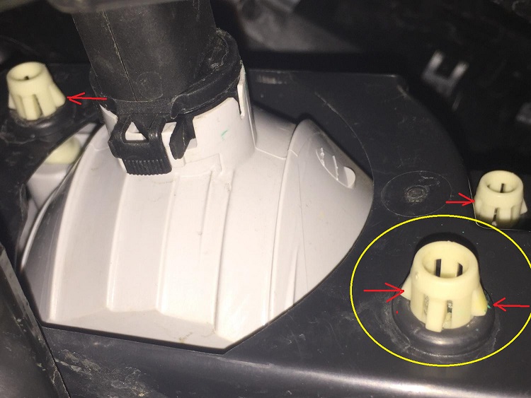

They are retarded, bunch of trained monkey's whichever dealership you went to. You adjust them using the 3rd leg with the teeth/gear like knob

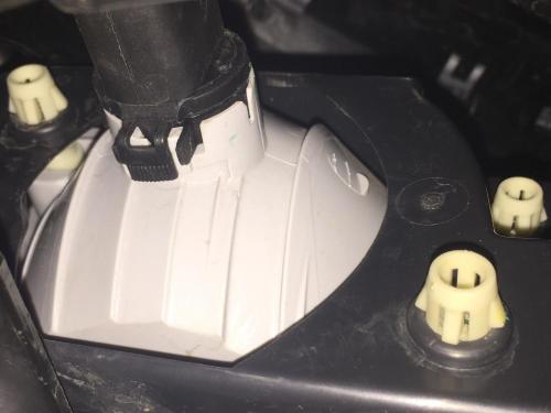

Push these pins in, you will see what I am talking about
keddie has a picture showing it is adjustable too (technically, the silverado ones are all adjustable, just the last peg IS designed for adjustments
Ok I'm starting to see it. Will the fog light just pop out the front after I push those in? How do I know if they are in the right height location if I can't adjust them with them on the truck? Thanks man!
