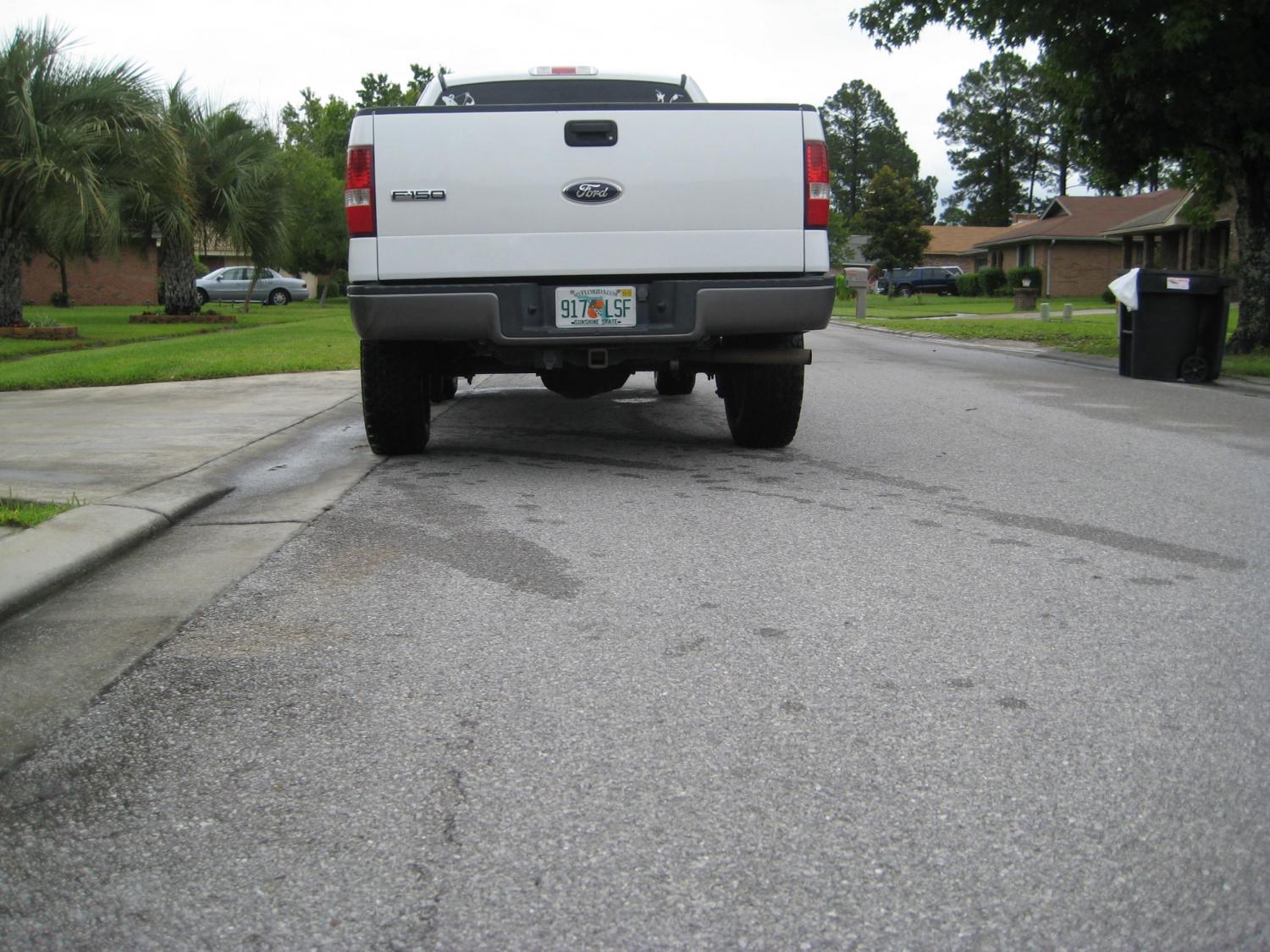

The tread width of the KO and KO2 is still 9" in 275....do the KO2 have a wider section width? Post up some pics from the rear of your truck. Here's one of an F150 I had with 275/70r18s. Looked great from the side....skinny from the rear.
