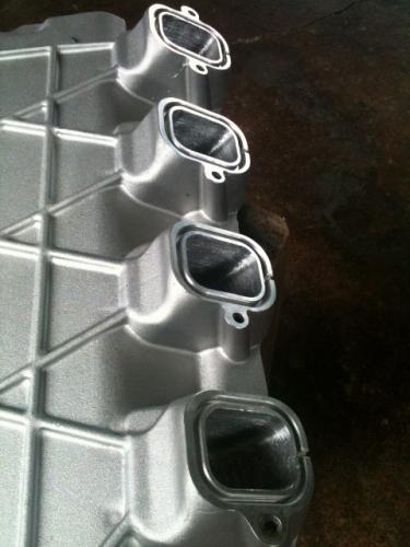

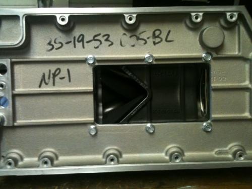

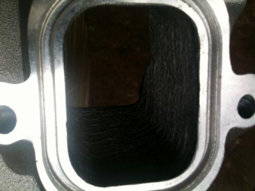

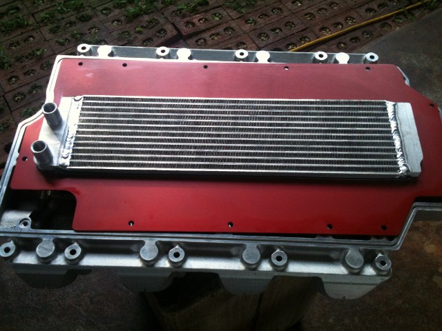

Since I can't leave shit alone I cleaned up the crappy ports on my TVS1900 here are some pics for those who have never seen the inside of a blower. It probably won't make anymore power but efficiency should be raised a bit. BTW the cooling Brick is a small 15" x 5" x 2"
