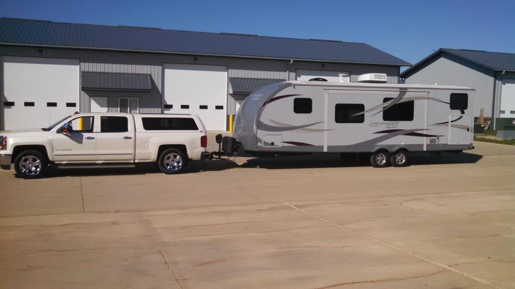

Here is my rig as the hitch is currently setup. As you can see, there is significant sag in the rear of the truck. I might try to re-configure my WD hitch to get another link in the chain and get even more tension on it.
I did order Airlift 5000 ulitmate air bags for this truck. I can run another 10 - 12 PSI in my tires as well. I will post once the air bags are in.
Thanks again for the help
Is that an Open Range? I have a 2015 LT308BHS. Love it. Let us know how the bags work out for you. I may put some better shocks in the rear to help control the rebound on rough highways.
This is a Viewfinder Signature 28bhss.
It does sound like your hitch isn't fitting or working properly. You might need to find one that fits the setup better--though keep in mind once you eliminate sag with the airbags the hitch might fit better (looks like you're getting about 3" of sag). You can tow that much without a WD hitch and you'll probably be fine with the addition of the airbags, but a properly working WD hitch, especially with sway control, is going to be the best setup even with the bags. Of course when they're not working correctly they can do more harm than good.
I've towed heavier trailers with more tongue weight than that without WD just fine with the bags, but nothing that long that will catch as much wind. Either way, you're going to love the airbags. I also have the Airlift 5000 Ultimates and they work well. With some gear in the back as well as the tongue weight, start out around 50-60 psi and adjust from there. They should solve about 75% of your issues all by themselves. But certainly keep better shocks, tires, etc, in mind for the future.
