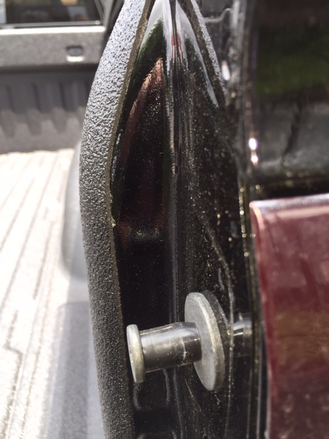

Here is the GM thickness from factory.
Would only point the finger at the dealer and who ever they trust to spray their trucks.

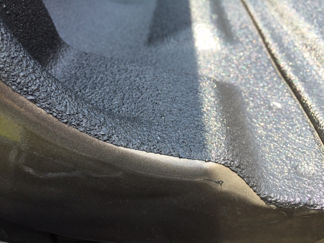

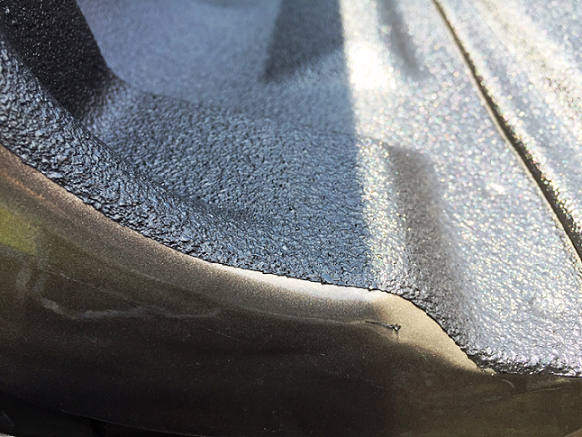

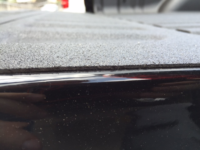

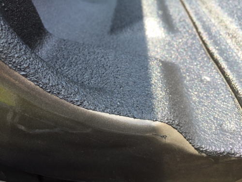

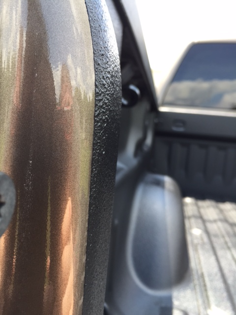

A few pictures of mine vs. one done at the factory. A very large difference in thickness which results in a large difference in quality and performance. Ill get some more when they respray it. Hopefully sooner than later.
