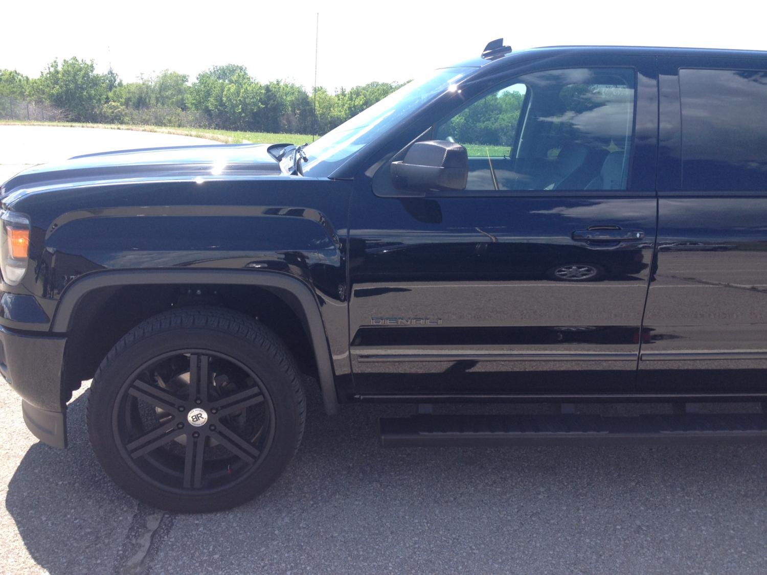

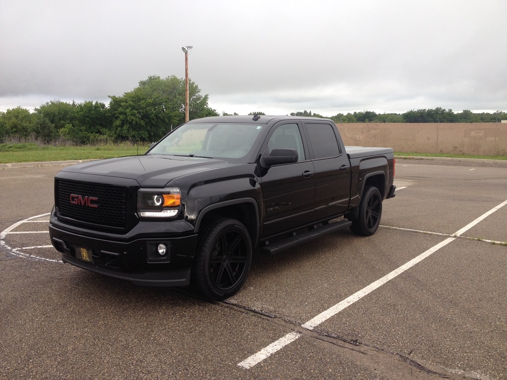

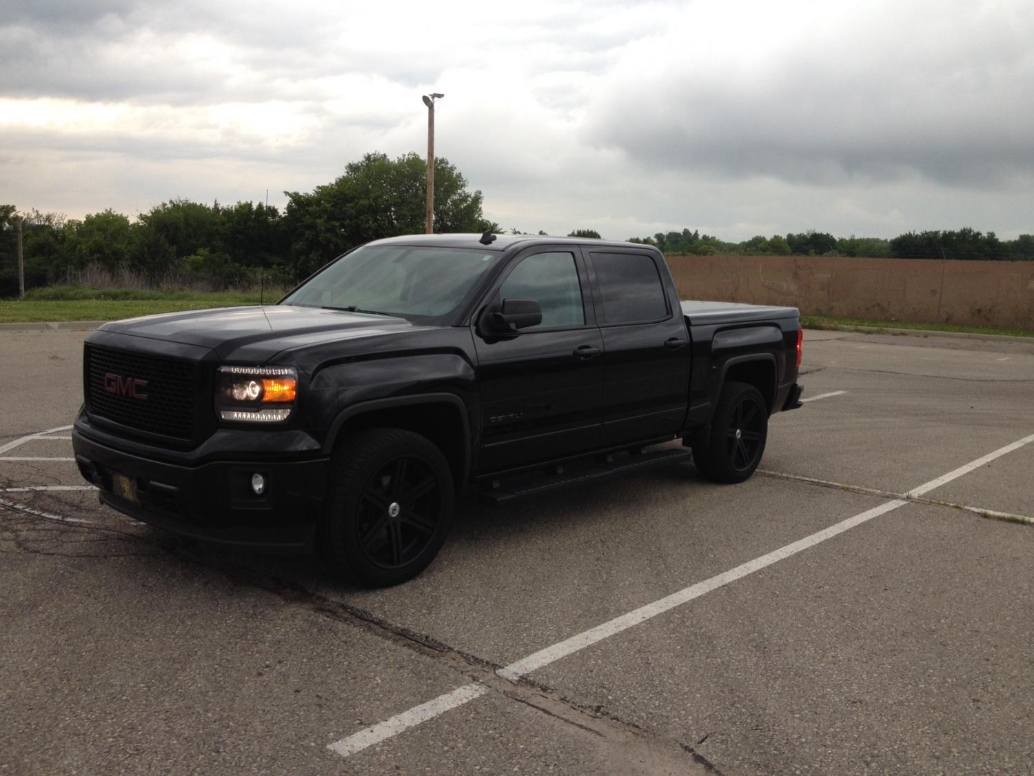

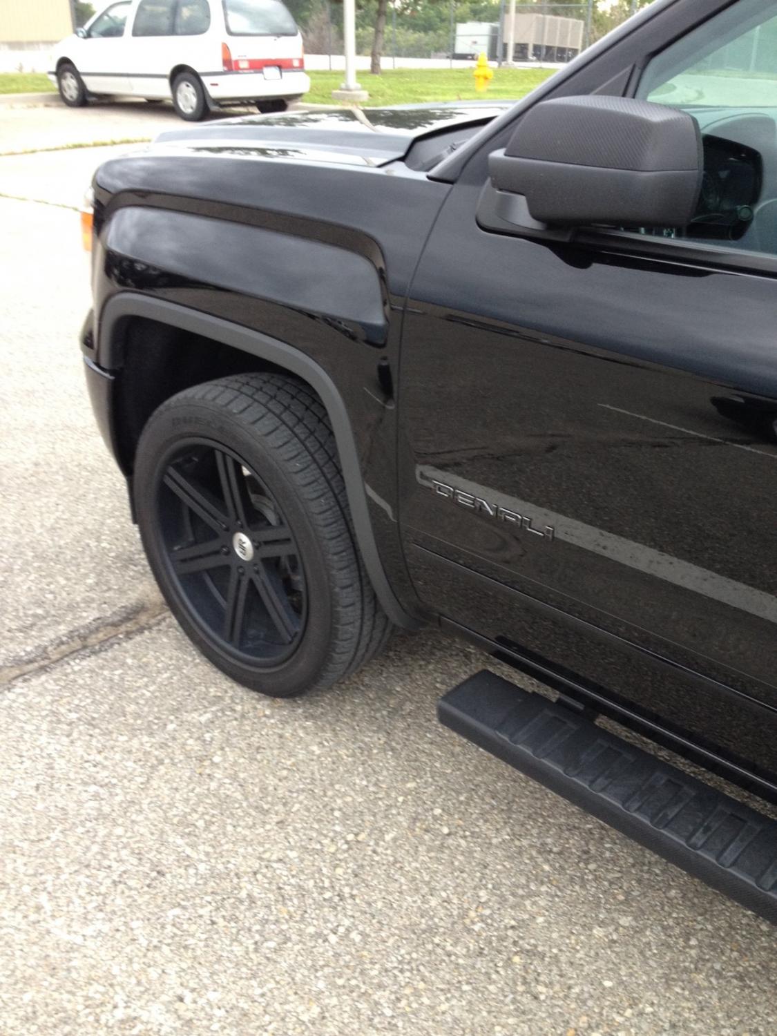

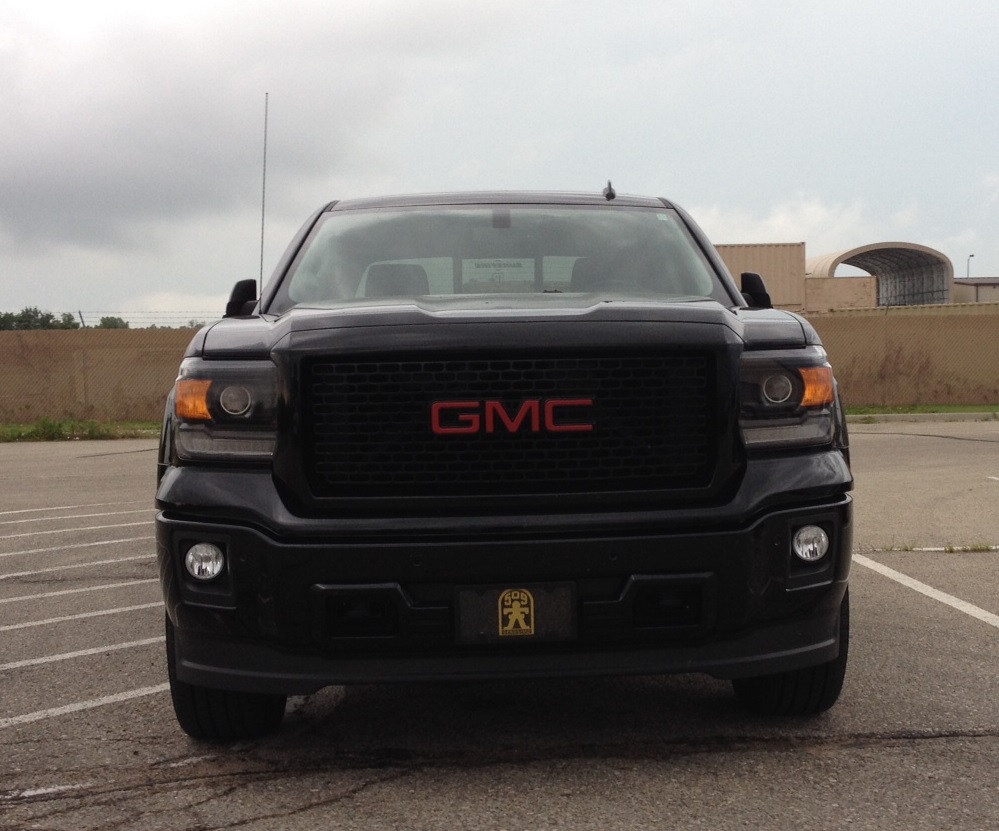

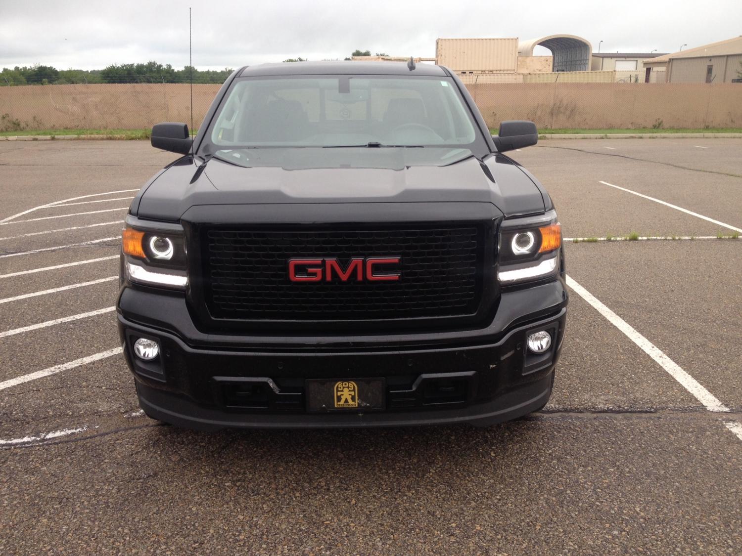

Took a few shots of my truck this morning to add to the post. Still need to detail it, got almost nothing done this weekend.

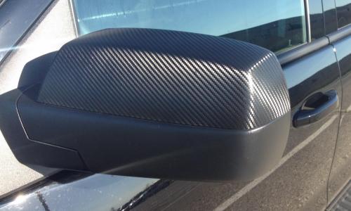

Carbon Mirror Covers and Running Boards. Black Chrome DENALI Badging.

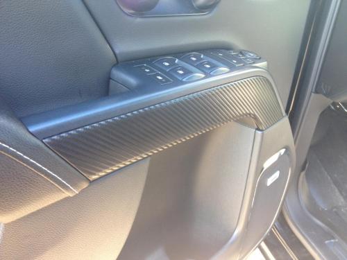

3m 1080 Carbon Fiber Wrapped Interior Panels

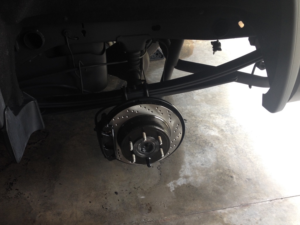

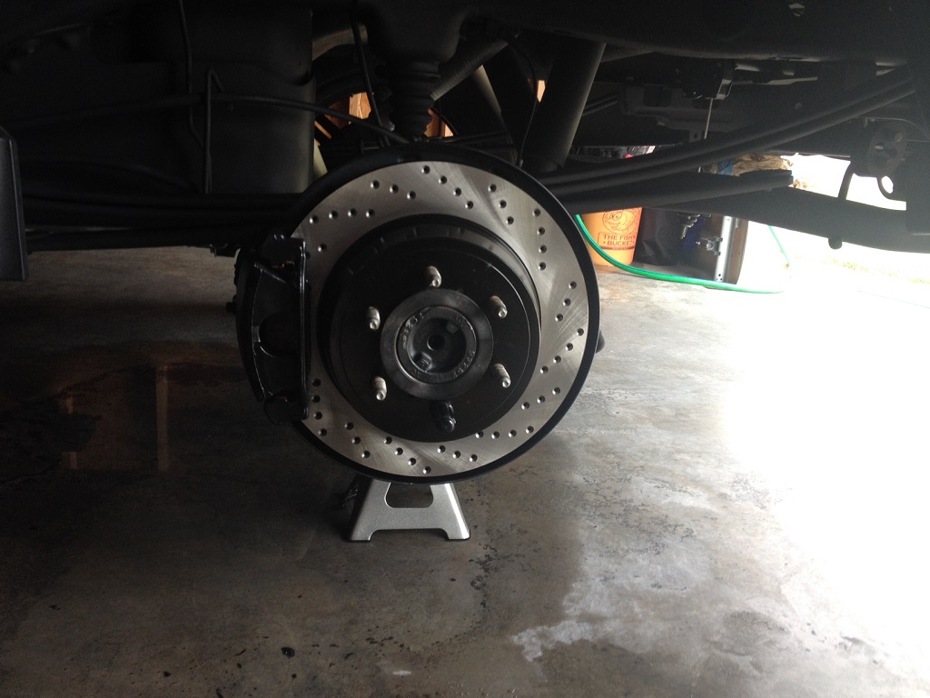

Completed the Stoptech Drilled Rotors in the rear with Hawk Peformance HPS pads. Color matched the caliper. Added BC Shadowed Center Caps. Completed spring cleaning underneath which consisted of a good wash and VHT.

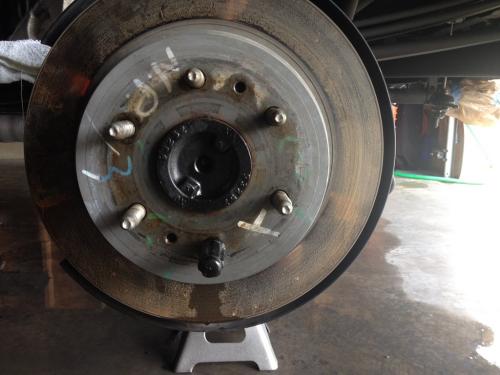

Looks good. I notice your're new rotors have what appears to be a spacer around the hub. Looks like it makes your wheels lug centric seeing how theres no lip left for the wheel to sit on?
Those are actually centric spacers added on by me. I have about 6 sets of them given to me by Discount Tire. When I took the first "Before " photo, I had already removed the spacer, you can still see where it was.
Ahh so they're hub centric rings for your rims? That makes sense. I noticed because I was running 1/4" spacers on all four corners to get my front tires to clear the sway bar and I was getting a hobble on the highway so I took them off. Our trucks have about 1/2" of hub, but the way my wheels bevel where the hub mounts on kept them from going on perfect. Hard to explain, but now I think I'm going to get the ready lift 1/2" hub centric spacers, hard to justify the cost of them though.
