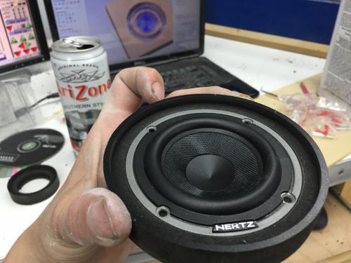

Here is a sneak peak of the work in progress. Speaker baffles for Hertz HSK-163 Hi-Energy. The beginning of a much more complicated mounting system. More to follow as it gets done.
Hertz HT-25 Tweeter
Hertz HL-70 Midrange
Hertz HL-165XL Midbass (Not Shown)

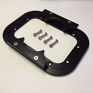

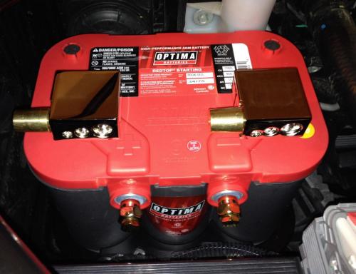

Mounted Aux Battery this weekend. Modified billet plate and adapted it to the existing GM Battery Tray. Rock solid.
Phoenix Gold GM Binding Posts & KnuKonceptz Terminals attached
Working on an isolator tray and upgrading stock power and ground cables to Stinger Pro 1/0 Gauge with gold ring terminals.
More to come....

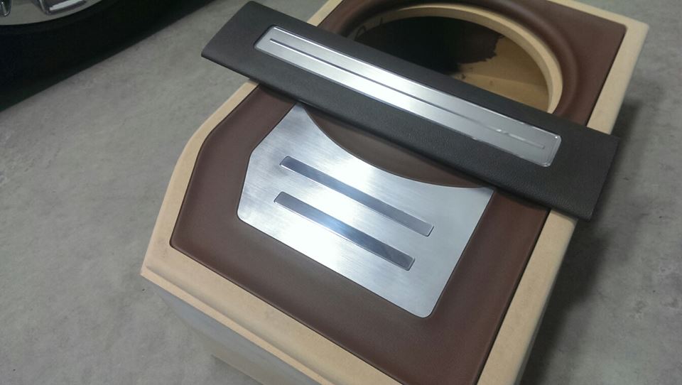

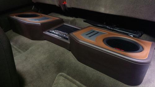

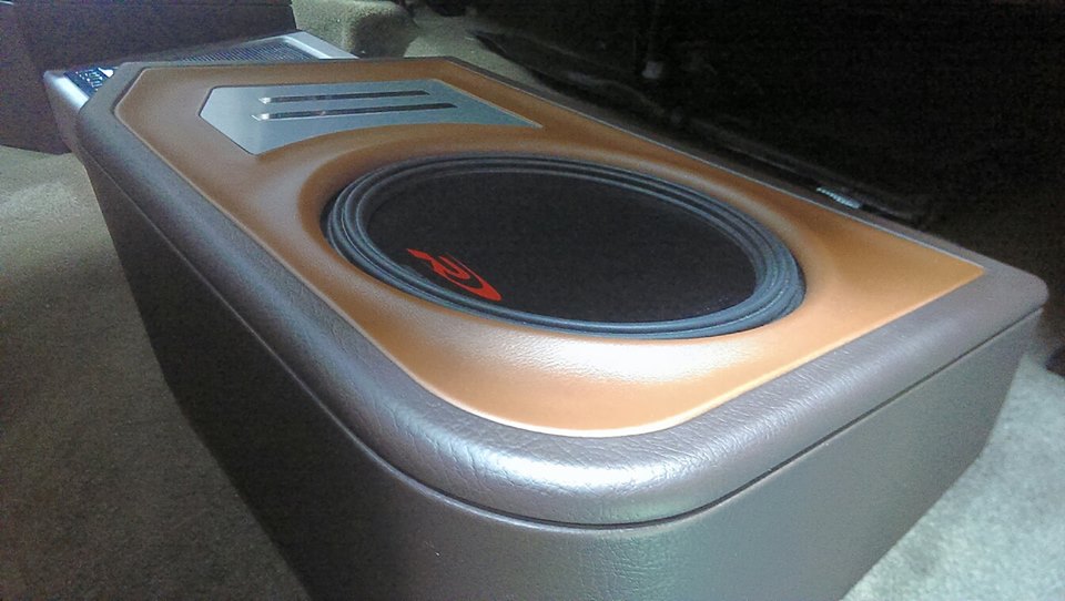

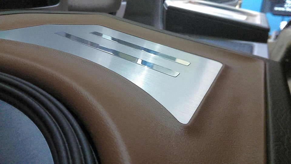

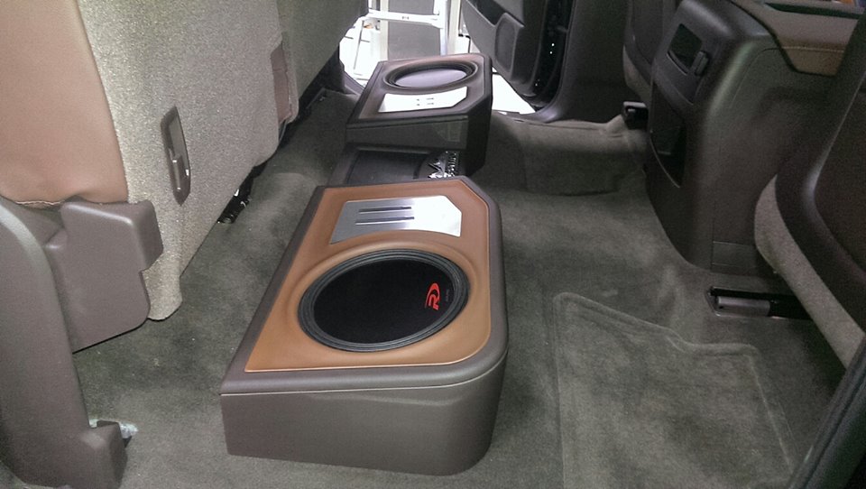

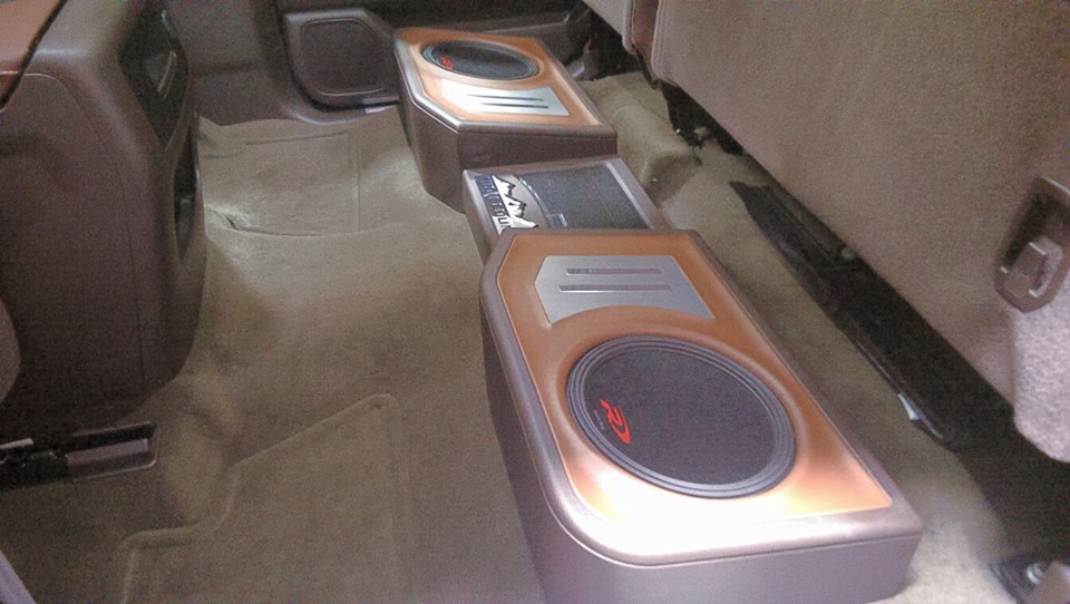

My friend Kyle Golden asked me to share his build, so I am. He is doing fab work for my Audio build and does the cleanest work I have ever seen. Here is a link to the formal post I made earlier, and his Facebook album. He just finished his truck for the 2015 Installer of the Year Awards in Dallas last week. He again placed in the top 12 in the country.
http://www.gm-trucks.com/forums/topic/176404-car-audio-build-2014-silverado-by-kyle-golden/?p=1671158
https://www.facebook.com/#!/pages/Kyle-Golden-Audio-Fabrication-Design/1057473470951994
If you want some work done, send him a note, and get in line!
