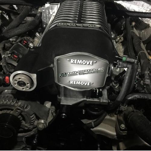

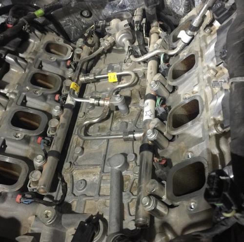

I have a 2014 gmc sierra with whipple supercharger, i locally tuned the car but since then my plugs are running out and the car missfires while hptuners doesnt show any knock at wot!
I returned stock plugs and it seems better a bit with miss fires however whipple doesnt recommend them, whay solution can i do?

Put some pics of the install up here, so we can all drool over them!
