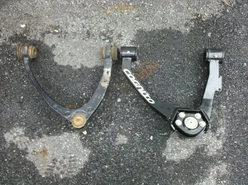

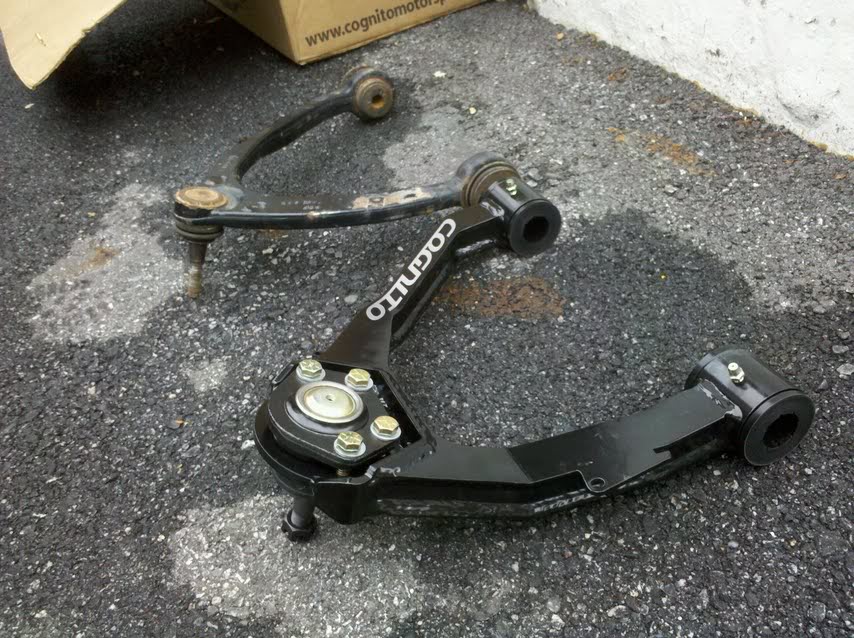

Can't say much about the TC control arms... haven't seen any on a 2014+. I installed the Cognito UCA's. Fully welded and solid build quality - they feel like they're a solid chunk of steel. I went with the bolt-on ball joints over the uniball joints. $512 plus free shipping from AP. Great guys. Even got a hand written thank you note a few weeks later.

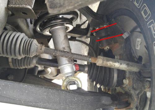

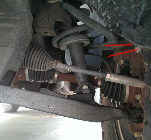

A lift/level changes the ball joint angle of the UCA enough that it can lead to accelerated BJ wear. With a 2.5" level, driving off-road or even on rough pavement will cause the stock UCA's to hit the droop stops, bind the ball joints, and overall make the ride shitty. Some guys won't be bothered by it if they're lucky enough to have decent highways and never take their truck off pavement.
A decent aftermarket UCA will correct the angles to compensate for the geometry change:
2.5" Level with stock UCA
2" Level with Cognito UCA
Not a perfect comparison but it gives you and idea.
Another benefit of an aftermarket UCA is that a decent one will have grease fittings. Mine have poly bushings with grease zerks plus a grease-able bolt-on ball joints.
