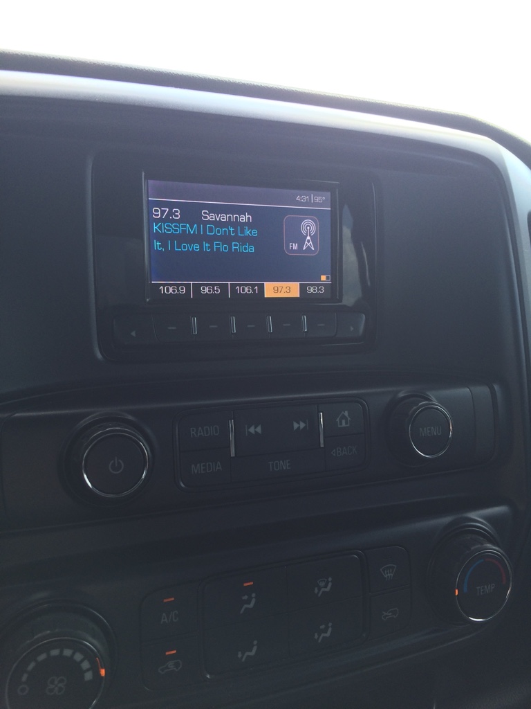

Any pics of your setup?

The quirk it had was the vehicle had factory front sensors which this piece displays via your aftermarket radio display which would show up everytime you put the truck in drive. Whether or not something was in front of you. If you interrupted it by adjusting the hvac it would work normally until the next startup. All in all a very cool piece.
This is mine and I love it, I got a hotspot in the truck so I always have Internet.
