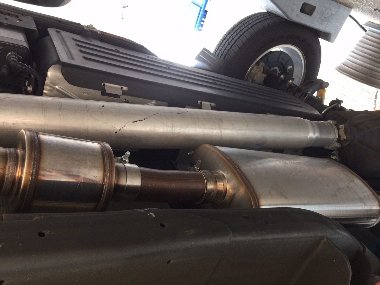

It sounds awesome and isn't as obnoxious as I feared. I went on a decent highway trip today with the wife. It's not bad, but a little louder than I would for a longer trip like considering I'll be towing in the future (higher load-more noise anticipated) and the fact this muffler will likely breakin and get louder. I have some resonance but it's mild. With 3.42 gears once you're at and above 75 it's alittle louder than I'd like. It's hard to describe since this is so subjective.
Tomorrow I'm going to add a Magnaflow 14159 race muffler upstream of my big magnaflow to act as a resonator. It arrived today, gotta love Amazon overnight shipping. It's a race muffler that's 6" in diameter and 6" long, 12" long overall.
My towing today only consisted of pulling my boat from the storage unit to the ramp and back which is 1 mile round trip. I didn't get a chance to pull it on the highway.

Mostly. I'm delayed a little because I thought my coworker had 98-2 gas on hand that I could mig SS with, but he didn't. I ended up clamping the small magnaflow just upstream of the big one. Nice improvement and I'm done in terms of mufflers minus some welding. I don't mind two clamps in the system, but four is too much-the little muffler including the slits I cut to aid in clamping is getting welded up.
The exhaust sounds great. It's just very deep and roughness/rasp is gone. It still sounds very, very deep and has the sound of headers including valve noise at idle and low RPM's but it's more subdued under non stressed driving. Driving at 75-80 with the cruise on is no longer annoying. The wife noticed a difference and didn't find it annoying when we went to dinner. I just wish that little magnaflow wasn't so expensive, but it was very effective for its size. I didn't find many mufflers that could fit in that small a space as 12-14" was my longest straight run with clearance upstream of the main muffler.
