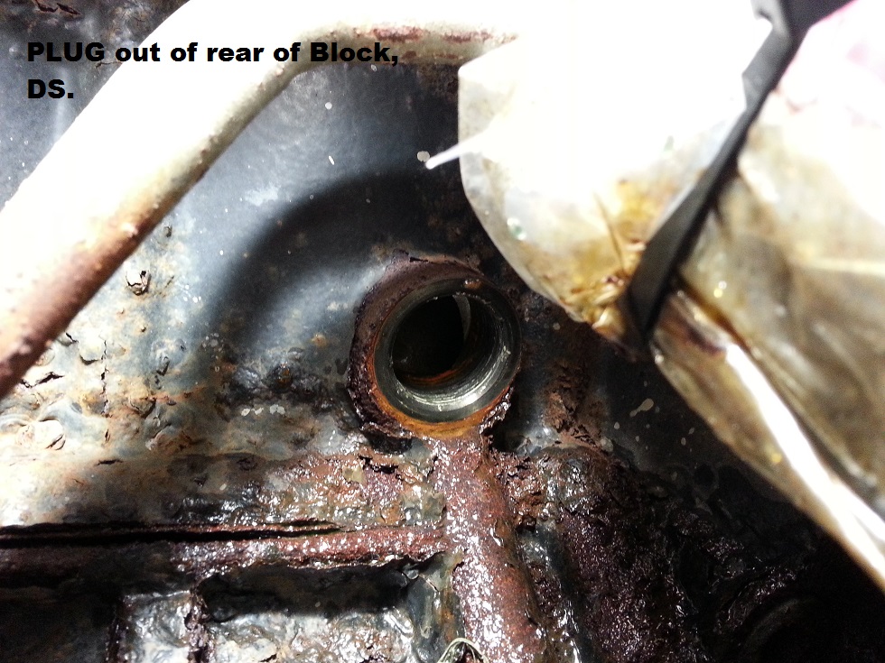

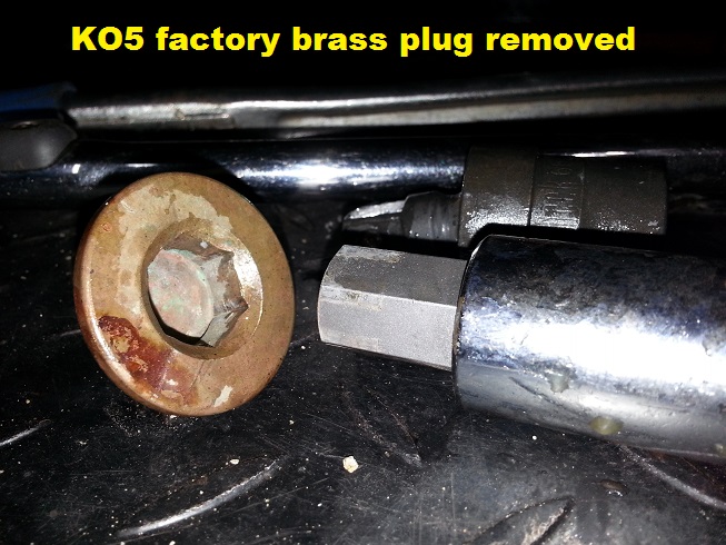

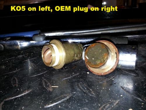

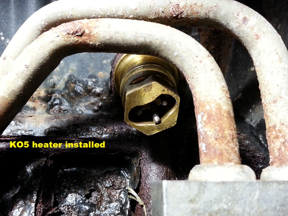

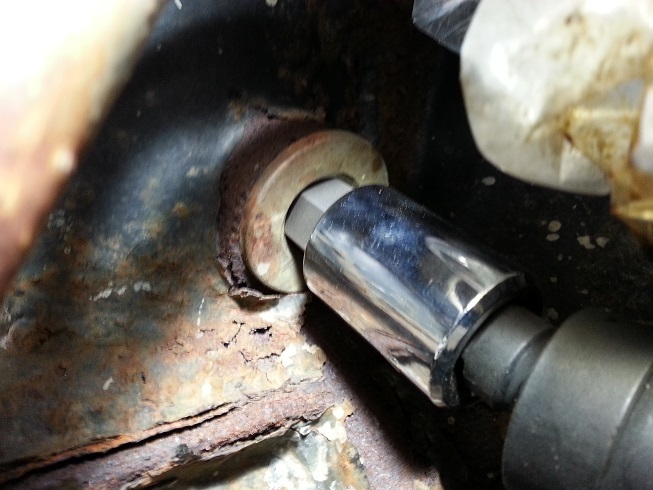

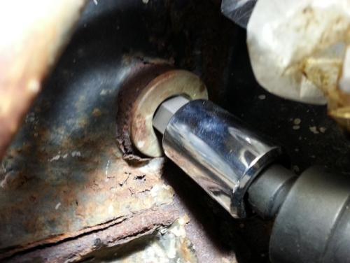

I have a Ko5, its in the rear on the DS, tight fit for the connector thats on it I noticed. I run a 160 Thermostat, and a big oversize tranny cooler and I have zero codes, and my truck runs in closed loop at -20 oF . I do NOT have any added engine tune that may require all temps up to xx degrees for what it consideres better perfomance. I do Tune my trans shift points and adjust speedo for tire size though. I believ the napa heater threads in the factory hole in block in rear and it made by same company that GM uses , mine was made in canada last time I saw the sticker on it. Many Block heaters for almost anything with an engine seem to be made in Canada, which makes sense.

The aftermarket KO5 does NOT have a thermostat in the cord. , just installed one in a friends 6.0 HD truck. I use mine on a timer on days I will use my truck in the winter as it sits for many days un used. I also put an aftermarket cord on mine to eliminate the thermostat. I do run a 160 Thermostat in the LS, so a block heater helps quicker warm ups.
The CORD end that plugs to the KO5 is heat resutant and will touch the oil lines.
