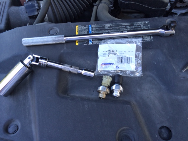

Ordered ACDelco # 213-4411 from Amazon for ~$25.
Borrowed 1-1/16 1/2 inch deep socket from work.
Removed connector from old sensor.
*** this can be tricky if you have never done this. I learned the whit/grey clip that is on the connector has to be pushed up and out from the top. It actually comes off. Then if you push the connector towards the direction where the clip was, it comes off easily.
Removed the sensor with 1/2 inch 1-1/16 deep socket with swivel attached and 5 inch extension and ratchet.

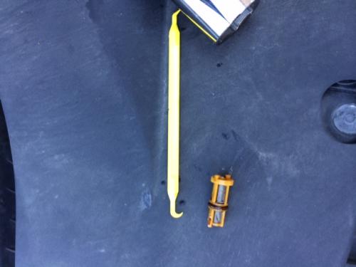

Removed the screen with small plastic pick I had.
Mine was really clean, so I just put it back in.
Installed the new sensor and re-connected the connector.
Started her up and pressure read ~42 at idle. Drove around the block and she goes up to ~50 when I get on the gas.
