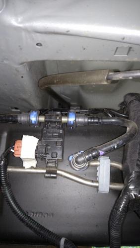

K2XX 5.3L Pic Request - Flex Fuel sensor mounted on the frame
Here are all the parts I ordered.

Did you order the mount for the sensor and fuel lines?

Nope, do you happen to know part numbers? I figured the existing line brackets would work still.

Yeah I list the factory part numbers below but you need at least one bracket. There is a specific bracket that holds the sensor and bottom fuel line to the frame once you install the sensor. Without the sensor and bottom fuel like would be floating. Other than that I was going to order 4 or 5 fuel line clips just in case any break and it looks I may need an additional two once the new fuel lines and flex hoses are installed.
Link to parts
Clip for sensor and fuel (20967866) - 14 on diagram
Fuel line clips(15168646) - 12 on diagram
Below are the parts I was going to order
Flex Fuel Sensor - 13577429
Flex Fuel Sensor Clip - 20967866
Flex hose/fuel line (towards engine) - 23171538
Flex hose/fuel line (towards fuel tank) - 20967834
Fuel line (towards engine) - 23171532
Fuel line (towards fuel tank) - 23158923
Fuel line clips - 15168646
You're correct on the brackets, they are now on order as well.

I will keep you posted. My tuner (who is also doing the install) mentioned something about the fuel lines needing some tweaking (not sure if that is because I have a 5.3, will have to cross reference vs 6.2 part numbers).
Truck is at the tuner, he as the baseline and 91Oct tune and dyno completed. He is planning on the E85 tune/dyno tomorrow.

Mine on top, stock on bottom.
