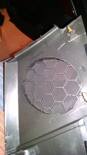

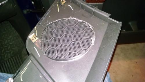

The grill before and after I removed some of the ring using a dremel. The ring would have hit the speakers if the material was left in place.

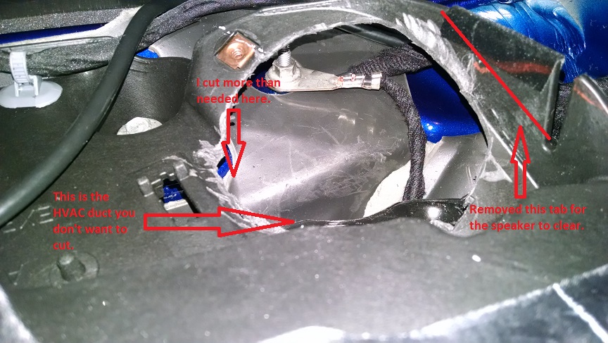

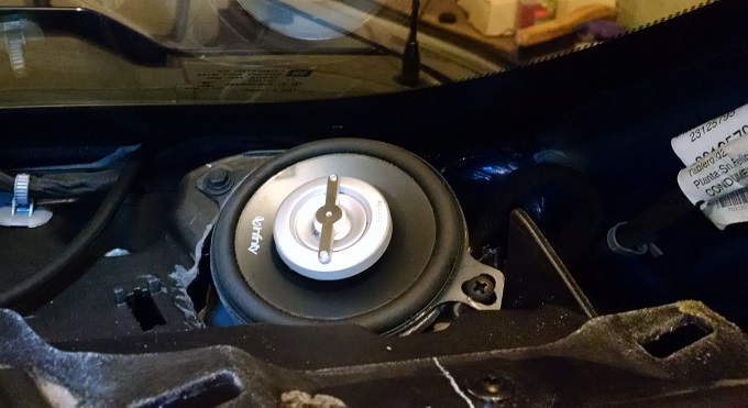

The passenger side cutout and speaker installed. The driver's side turned out much nicer but I had to get ugly with the passenger side trying to get enough material cleared without cutting into the HVAC ducting. This is definitely where I realized a set of tweeters would have been better than cramming in another set of full range speakers.
