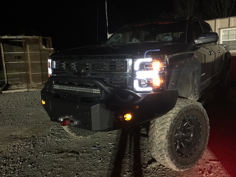

If you get a hold of Yukon Ring and gear they offer a kit to put their Duratrac 9.5 Carrier in the 9.76 housing. I just swapped mine over from the stock 3.42's to 4.56's. I have a 6.2 with 12" total lift. I'm running 40x14.5R20 Super Swamper M16's. Have over 1000 miles on since the re-gear and have no issues. Total cost to swap both the front and rear sets was right around 1800.00 with me doing all the work.
