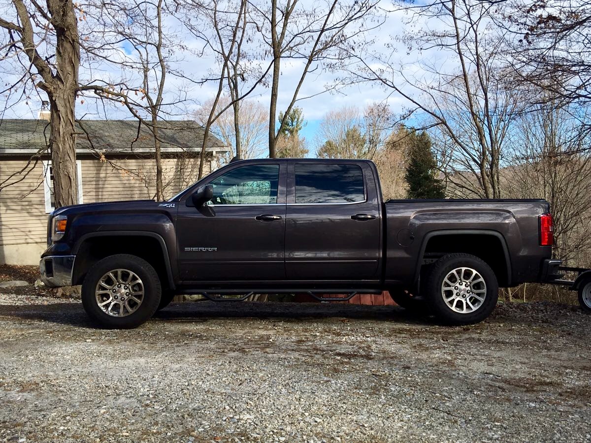

So it turned into a successful weekend! Got the level kit on and threw on my bars. I'm beyond happy with how the truck looks and sits now! I can't justify dropping the money on tires right now, but will be going to a bigger tire when the stockers are more worn. That should complete the look nicely :)post-149894-0-76325900-1449519251_thumb.jpegpost-149894-0-27330700-1449519329_thumb.jpeg
