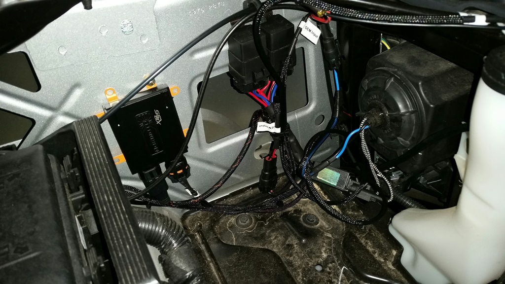

I did this install a few months ago. I'm not 100% happy with the wiring cleanup, but it works. I had to extend the leg to the passenger side.
I hung the driver's side through an existing hole in the inner fender. That allowed me to get battery power directly from the input on the fuse panel that side. The passenger side ballast is actually mounted to an existing hole under the radiator overflow jar.
Thanks again everyone. I just finished mounting and installing everything. The lights all work as they should. Now i just have to wait until nightfall to see how they look. I went with mounting the relays on the passenger side and fit everything in.
