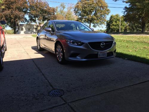

To the OP if you want to get more shine you need to polish, you can't really accomplish any polishing without a machine however, a porter cable DA polisher is cheap, $120 or so, and will save your body for waxing as well. Don't waste your money and more importantly your time applying polish to your truck without a machine, unless you've got about 40 hours to do the work and your built like popeye it ain't gonna get ya anywhere. Silver can look great my wifes Mazda 6 looks awesome.
