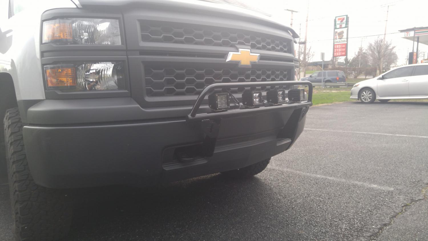

I am in need of some help,
I just recently purchased the N FAB off-road light bar similar to what is seen in this link.
http://www.autoaccessoriesgarage.com/img/group/main/41/4183_3_lg.jpg
I tried to install it last night and ran into some problems, I was able to get the tow hook bolts out without many problems but trying to get them back into the frame holes with the new bar is almost impossible. It doesn't make sense to remove the bumper because the bumper has to sit behind the bar, the problem is the bumper supports are in the way so bad you cant get the 5inch bolt into the hole without it going in on an angle which does not work obviously
Does anyone have suggestions or ideas? Because I'm really stuck/frustrated

After a lot of trial and error this bar can be installed without drilling and without removing your front bumper. There are 2 bolts on either tow hook and the drivers side is was does all the work really of not allowing the bar to move. You have the front bolts which hold the bar into the frame nicely, then the 2nd bolt (rear one) on the drivers side is what keeps the bar from tilting up and down. In the box NFab supplied 1 bolt with washers and a lock nut, you can install this on the passenger side if you wish to have a bolt go through tow hook frame rail and the bars bracket. But I have found the 3 stock bolts already in place do the job well.
