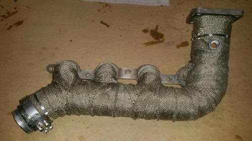

Don't have any at the moment but it's pretty much the same as the past generation trucks. Literally the only thing different is the manifold flange. Not kidding, I cut up a log I made for a ls3 and welded on a new flange lol. But yes I need to post more pics, here's one of the log itself.

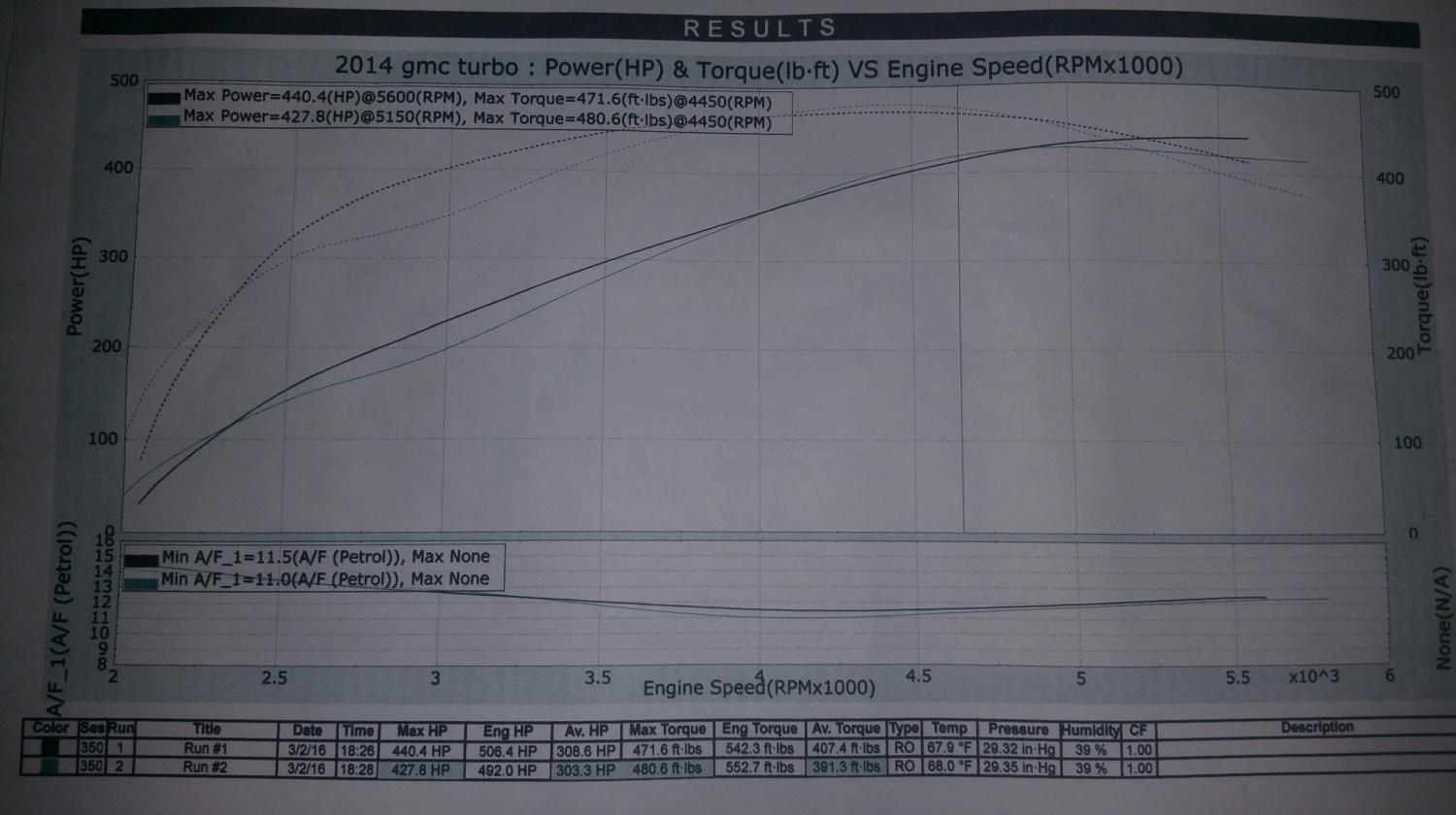

Had a few set backs but finally had it on the dyno. On 5 psi it made 440 whp 470 wtq. All on 93 octane and 14 degrees timing. Still sorting some transmission bugs out but feels strong so far.
