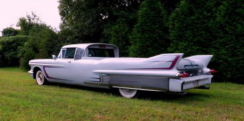

Thanks for the reply. My Series 75 is 20.6 long (Limo). My 1958 Sixty Special Custom is 165" wheelbase. (13.5') and 257" / 21.5 feet long. I think it will fit on an 18 foot trailer with a tad of overhang and you are right. There are a lot more 18 footers out there. I may get one, but right now I am looking for an enclosed trailer and I think that including tiedowns, I will need at least 26-28 feet floor space. This would be a gooseneck with a 26' floor and an eight foot overhang. I have an eight foot bed on my truck.

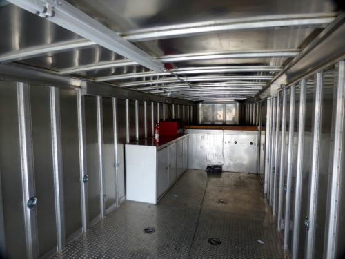

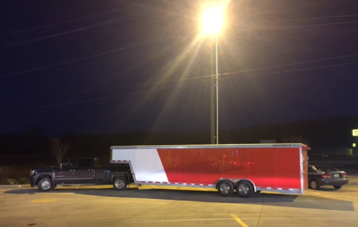

I thank you very much or going to the trouble to post a link. Trailer looks quite good. However I did just buy a used Featherlite in excellent condition. It is a 36 foot gooseneck aluminum. Weighs about 4,000 lbs and has two 7k axles. Hydraulic landing gear. double extension ramp that is about 12 feet overall giving me a long, low ramp that will clear my long, low cars. It also has a winch to pull the car in and out. I think it will do very well.
The gooseneck does handle quite well, but a lot differently than a bumper pull when making turns on roads t . You must swing wide or chance hitting the curb. The gooseneck wheels are mounted further back than a BP and this does make quite a difference.
Pulled it home - maiden voyage for me - I was amazed at the stability on the expressway! I normally cruise at 60-65 and get the best mileage with a trailer, I run faster unloaded. I had to watch my speed, because on the long boring stretches I was getting up to 80 mph without noticing it. So I set the speed control at 65 and came on home. No incidents.
