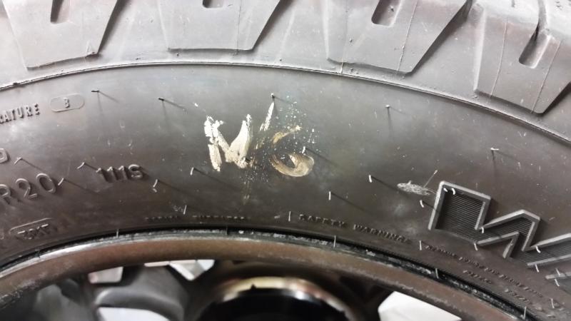

But, here comes the reason for this thread.. the tire that the GM Tech told the service writer was rotated 180 out because the machine suggested it and balanced (which multiple sets of weights in at least 5 positions (signs of "weight chasing" according to the Tech today) wouldn't balance out... so further inspection revealed that on the inside of that tire was written "N/G" in white paint or marker which also appears to have been partially scrubbed by the GM Tech that did the road force on 12/31 or factory (doubt it) or selling dealer (another why would they do that i picked the truck up with 6 miles on it i believe?)

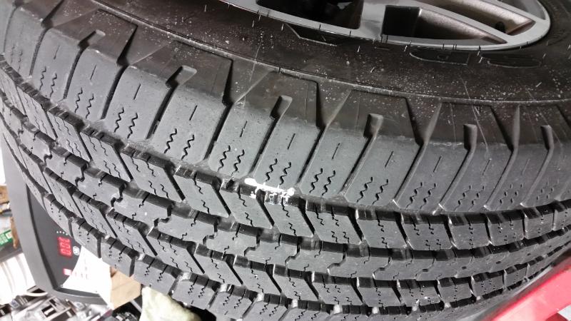

So now, i'm pretty disturbed, I have not left the tires or the truck with anyone since the 12/31 service and I didn't leave it's side today, my friend owns the shop, a 7k sqft facility with 7 lifts, a AWD Dyno and machine shop and five axis CNC machine, 2D printers you name it.. So the Tech who has been trained on this newer Snap On balancer and as I mentioned just calibrated, starts to rotate the tire manually faster and faster and says look, see that, I say no, but then sure enough there's a bump on the tread... now he and I run our hands on the tire as it's spinning pretty quick and have it spin faster, you can feel it, on the outer shoulder of the tire, it's a raised bump on the tread blocks just before the sidewall. OK, so i have him mark the spot in between the tread and also on the inside of the tire with the word "outside" in lower case letters with white paint marker.. so if the tread paint wears at least we remember where it is in case it decides to "not cooperate" when i bring it back to the dealer.
So, we then "chase" the weights and it balances eventually, again 5 differents posts in and outer rim till it goes to zero. I then call the dealer and talk to the service writer and I tell him about this and now I also advise him of the marks, chip the tech that worked on my truck on 12/31 made on that SAME RIM with the screwed up "N/G" tire (which if you go in the vibration thread you'll see i posted on 12/31 after the service visit along with the repair order).
I am upset because if their tech KNEW the tire was no good "N/G" why the heck would he reinstall it on my truck? wouldn't you think if he found such a problem with the trie to take the time to mark it "N/G" he would say something to the service writer and not reinstall it????? I have a spare.... what the heck? who would want their wife and kids in a truck with "N/G" tire on it traveling over bridges, driving on the hwy etc etc? I mean, I did it today knowing the tire is marked "N/G" but ONLY because I already drove it another 600 miles or more since this guy marked the tire that way including numerous hwy drives, some as long as 145 miles away! man, it's unreal people don't think of consequences like that??

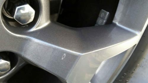

A) rectify the original wheel chip/damage to the lug nut barrel (zoom in) and the face of the wheel on my NEW truck..
