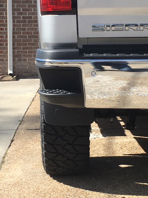

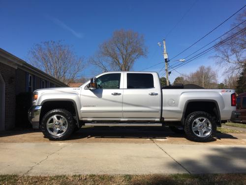

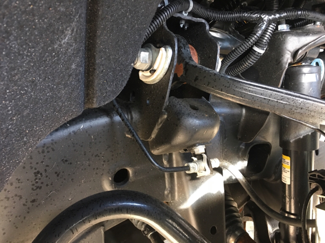

Tires and ready lift installed !!! Very happy with purchase . After intentionally trying hit every bump at hi and low speeds , turning and going straight the truck rides GREAT !!! Only did 1 1/4" to 1 1/2" of lift in front to level just a little with still some rake . Tires cleared lock to lock with any lift at all . I still have an inch gap between upper control arm and bump stop.
Tires were quieter than expected considering the tread pattern . Very pleased with this setup. Hope this helps. thanks guys post-152881-145590912186_thumb.jpgpost-152881-145590915424_thumb.jpg
Tires were quieter than expected considering the tread pattern . Very pleased with this setup. Hope this helps. thanks guys ImageUploadedByTapatalk1455909121.129426.jpg ImageUploadedByTapatalk1455909153.646232.jpg
ImageUploadedByTapatalk1455909201.187231.jpg ImageUploadedByTapatalk1455909211.004355.jpg
Truck looks killer!!!
I would have skipped on the leveling kit though as the stock torsion keys would have easily supplied the same lift for free.
Glad to see you have shock spacers though.
Again looks great!!!
