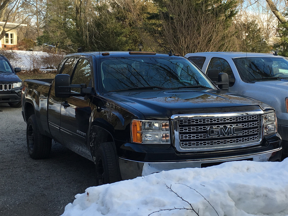

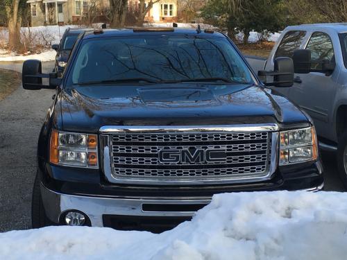

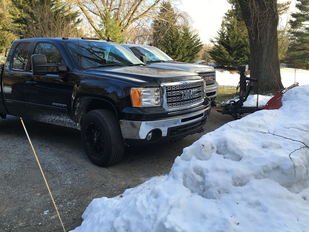

So I have been thinking about doing the Denali HD grille swap on my truck but I could not find one in my price range. I finally decided to give the Spec-D grille a try. Actually pretty decent quality. The biggest concern was the stupid solid chrome badge area. I thought about cutting out the G and C area but after receiving it, there is a stud to clip on the truck. So I painted it and I am happy with it for now. I might end up cutting it later down the road.
What do you all think?? Sorry the pictures are not the best, the snow was kind of in the way :/
