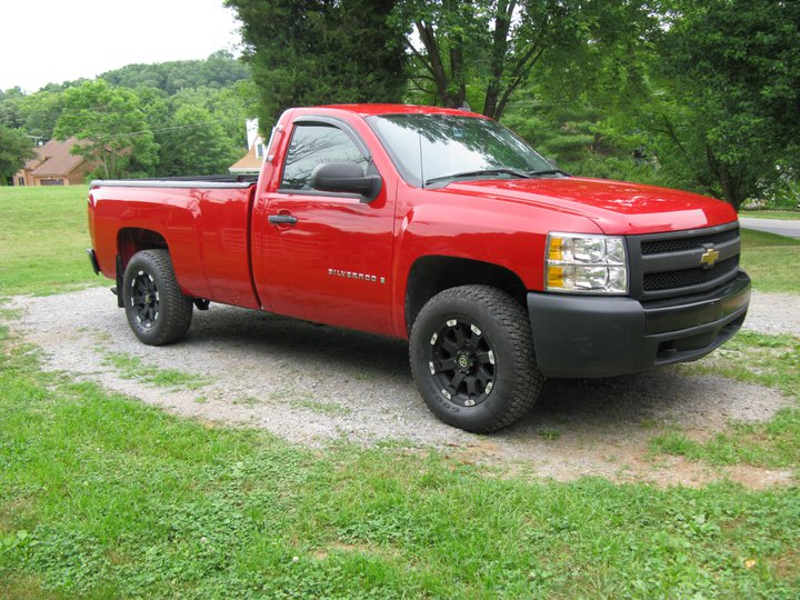

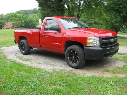

Hey guys I have read a lot up on the subject and can see that people are definitely back and forth on the matter. This is especially true for different situations unique to each individual. Therefore, I thought that I would come here and explain my case and hope some could give some advice. Firstly, and most importantly I will list my truck specifications.
2007 (New Body) Silverado 1500 4.8 V8 4x4 Long Box, Regular Cab
Now if I am correct my truck has a maximum limit of right around 10,000 pounds. My story is that I am a Landscaper that deals mostly in Lawn Maintenance and have been blessed by having my business extremely local. However, this year I have been offered a job that is going to require me to travel with a trailer. This is going to be a weekly contract where I have to tow the trailer probably about 15-20 miles each way.
Now I also want to use the trailer to get all my equipment to other customers simultaneously now too. Right now what I do is drive my truck to their property, trim, edge, and clean up anything that may be laying around. Then I drive back home and fire my mower up and drive it to their property to finish up. This has been a really great setup for me.
However, I cannot tell you guys how many times I have been at a customers property and wish my mower was there with me so I could get the job done. If I am going to have a trailer this year I figure I will have this new opportunity.
I guess all this text was not completely necessary, but it shows exactly what I plan to do. For example, if this is going to put a lot of extra work on the truck I will do what I have to do as far as modifying it or leaving the trailer home when I do not absolutely need it. It would be nice to be able to use it as a regular part of my business if I am going to have it though.
I went to a trailer dealer that I trust last year. The dealer was nice enough to let me tow around a trailer that I was contemplating buying. After just a short time (probably half an hour or less) of towing the trailer when I pulled back into the dealership I noticed a lot of heat coming from under my truck. I am going to guess that it was the transmission and the amount of heat was very unsettling.
Sadly, I did not check the transmission temperature and if I did I do not remember what it said. After me rambling on here I am certain that you guys can probably get a good idea of what I want to do here.
I also plan to have a tandem axle trailer, with a module installed in the truck as well. I think they are mostly to help with the braking of the trailer. I think the one I was interested in was 7' wide and 16' long. I think it weighed in at just over a thousand pounds.
Now if my transmission was getting hot while towing just the empty trailer around, it is even more troubling now. Because I will probably have an extra 2,000 pounds of weight on the trailer. I will probably end up dragging it around several times a week during the busy mowing season.
So finally to my question, should I be worried here? Should I be absolutely fine? Should I consider modifications like an aftermarket transmission cooler?
Also worth mentioning, my truck has nearly 90,000 miles on it. I believe that someone told me that this is a good time to have the transmission fluid changed as well. Which would obviously be worth considering if it is getting old. Especially with it getting hotter now that I am planning on towing with it regularly.
Hey guys sorry for this huge novel. Just want to be as accurate as possible here. Any advice would be greatly appreciated.

By the way I have always loved my 4.8 V8 as it definitely asserts dominance over lesser trucks. However, if I ever move up to a 2500, which I am considering I would love to have a 6.0 Vortec or 6.6 Duramax. Nice truck.

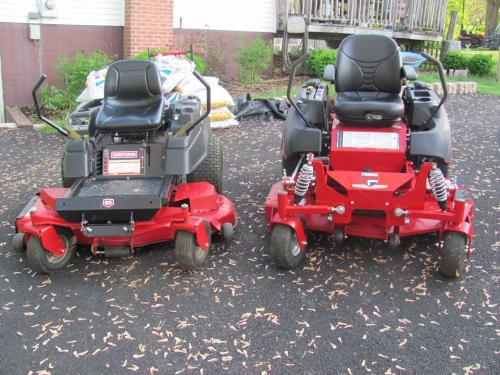

I do not think this is a big deal really. You are free to correct me if you think I am wrong. When I have both of my zero turns and all my other equipment on it I am probably going to be just over 3,000 pounds. So even if this is the case I am not even halfway to the limit of my towing capacity. However, I personally think that is a lot of weight to be towing around on a regular basis and want to do everything I can to prevent anything from failing.
