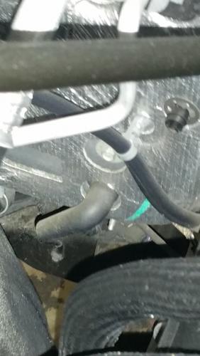

What is this?
Hey does anyone else get quite a bit of water dripping out of here? Is it just from the AC running? Seemed like quite a bit. I haven't had my truck long enough to know if it's normal...Thanks
Yup. It's the AC condensation drain. Mine drips a lot too. Nice sized puddle on the garage floor after running around, especially on the more humid days here in Texas...
Thanks for the confirmation. Ya I'm originally from Dallas, I sure don't miss those hot days!
It's important you know where that boot is... so now you know where it is.
If it gets musty smelling in your truck, it could be plugged and you give that boot a squeeze to get it flowing again.
Haven't seen that become an issue on these newer trucks, but on older ones it happened allot.
