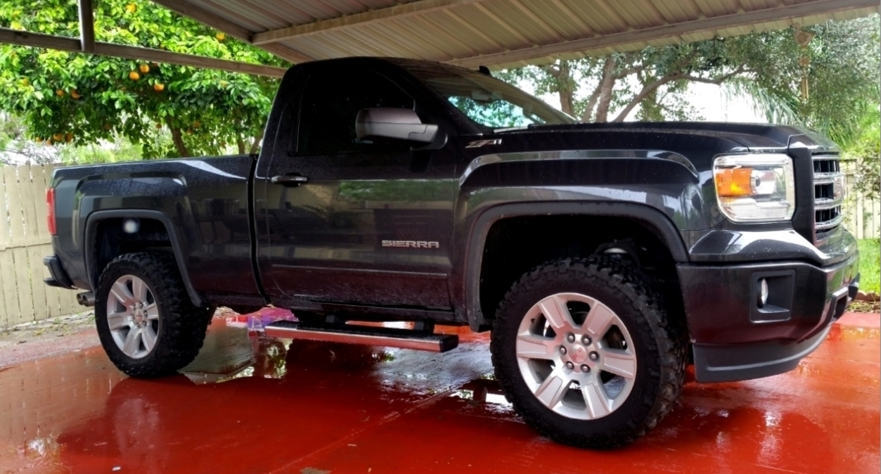

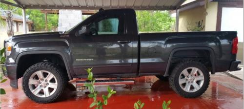

A bit dirty since it rained a couple days ago and haven't had a chance to wash it but here are the pictures with the 2.5" in the front with the 2" rear block with 295/55/20 nitto trail grappler.
