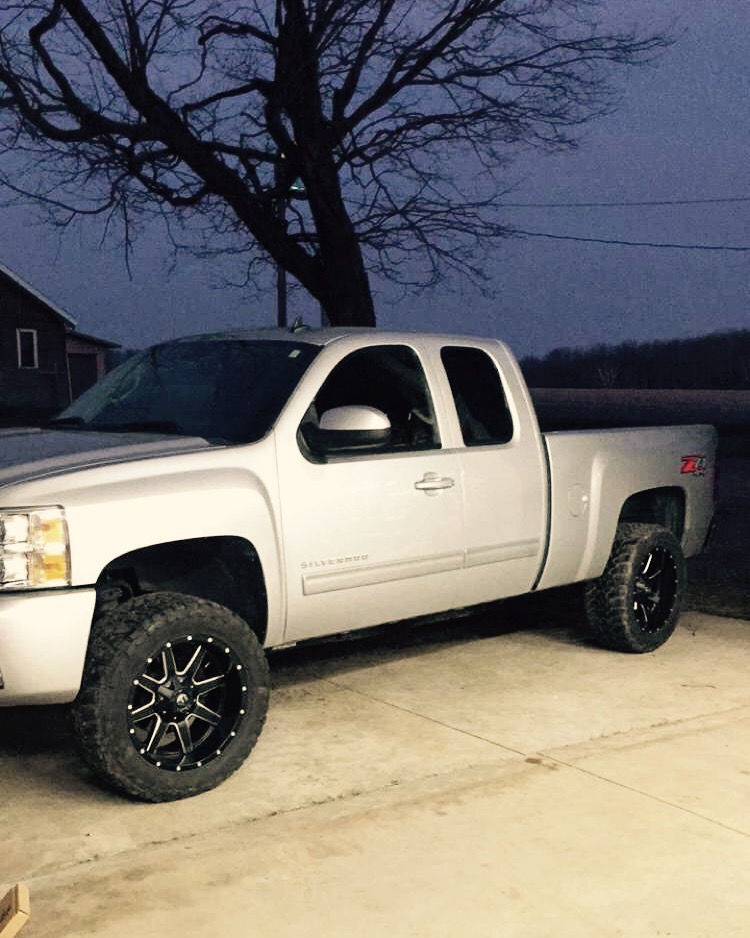

image.jpeg Well after a full day of wrenching, the 2.5" rcx level and the 1.25" body lift is installed. Fender measurement at all at 41 1/4" inch
After quite a bit of trimming they fit with no running. I did the small nor cal and then had to do the large nor cal to make them fit. The wheels are just so wide and the offset killed me.
I wondered if you would still have to go the Nor Cal route. That is a heck of a wheel and tire combo to fit under a 3.5" lift, but it sure does look good.
Haha thank you. We actually called our fender modding the wisco fender mod because we had to cut some in order for it to work. Then we hammered the lip up like the nor cal mod. Haha. I think the beer and the lack of energy was setting in at that point...
