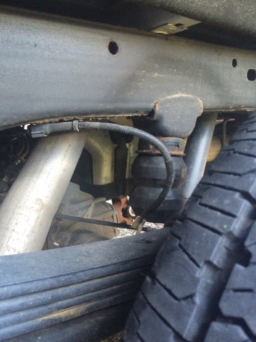

I'm not familiar with either of those options, but if you're just looking to get rid of the squat, maybe have a look at air bags as an option too. I installed a set into mine, and I'm impressed with how they're working.
