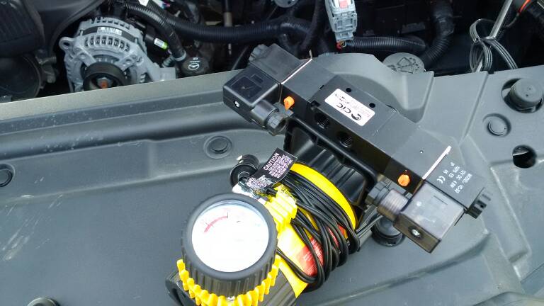

So, for a compressor and control panel its over $300, at least here in Canada. Being that I'm a pretty handy dude, I'm piecing it all together myself. This is the 12VDC pneumatic valve I'm using,

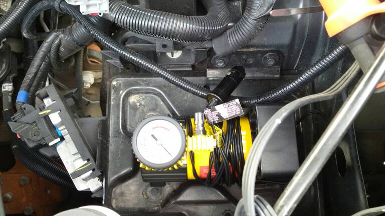

This is the compressor and where I'm going to mount it,
I'll be bolting the valve like this :

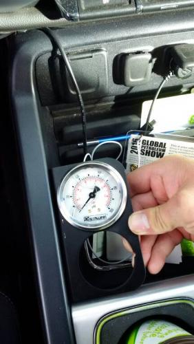

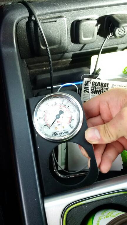

As for the controls, I bought an Autometer two gauge, gauge panel, I'm using a low pressure gauge, and a two position momentary contact switch. I'll mount the switch in the open hole of the panel. And I'm going to screw it to the side of the console here :
I was originally thinking of mounting it where you're talking, but my wife drives the truck a lot, and she's got a short wheelbase, so it would get in the way of where she has the seat.
