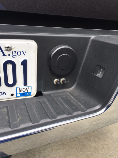

In for more info. You guys that have these kits installed - Did you opt for the on-board compressor and tank as well?
I did not. I have the air fill valves where the bolts to my license plate goes. 1262ec8141455845dafb4786257a55fc.jpg
The remote compressor add-on (with a gauge) would be really great if you have varying loads.
While you can estimate the load you are going to go get and use your home compressor to adjust before you leave - it'd be nicer to just drive to the destination and push a button till you are level. Or go the extra yard for the auto-leveling setup on top of the remote.
Now I have the trailer and weight distribution hitch all sorted out - 10 PSI is all I need, and I leave it there 24/7 load or no.
Lot of $ to add the remote compressor kit since I don't really need it for my particular use.
