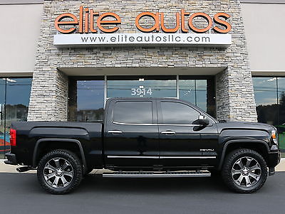

I saved this pic. Looks great to me. Ad said it had a 2 inch lift with 35x13.5/r22. This is the look in hoping for. Not sure about the ads accuracy. Said it was running 325/50/22, which is a 35. Truck in pic is not an HD. Was hoping the experts here could shed some light. Thanks!
It can be done with some trimming. go to the Leveling kit thread and do a quick search they are in there.
