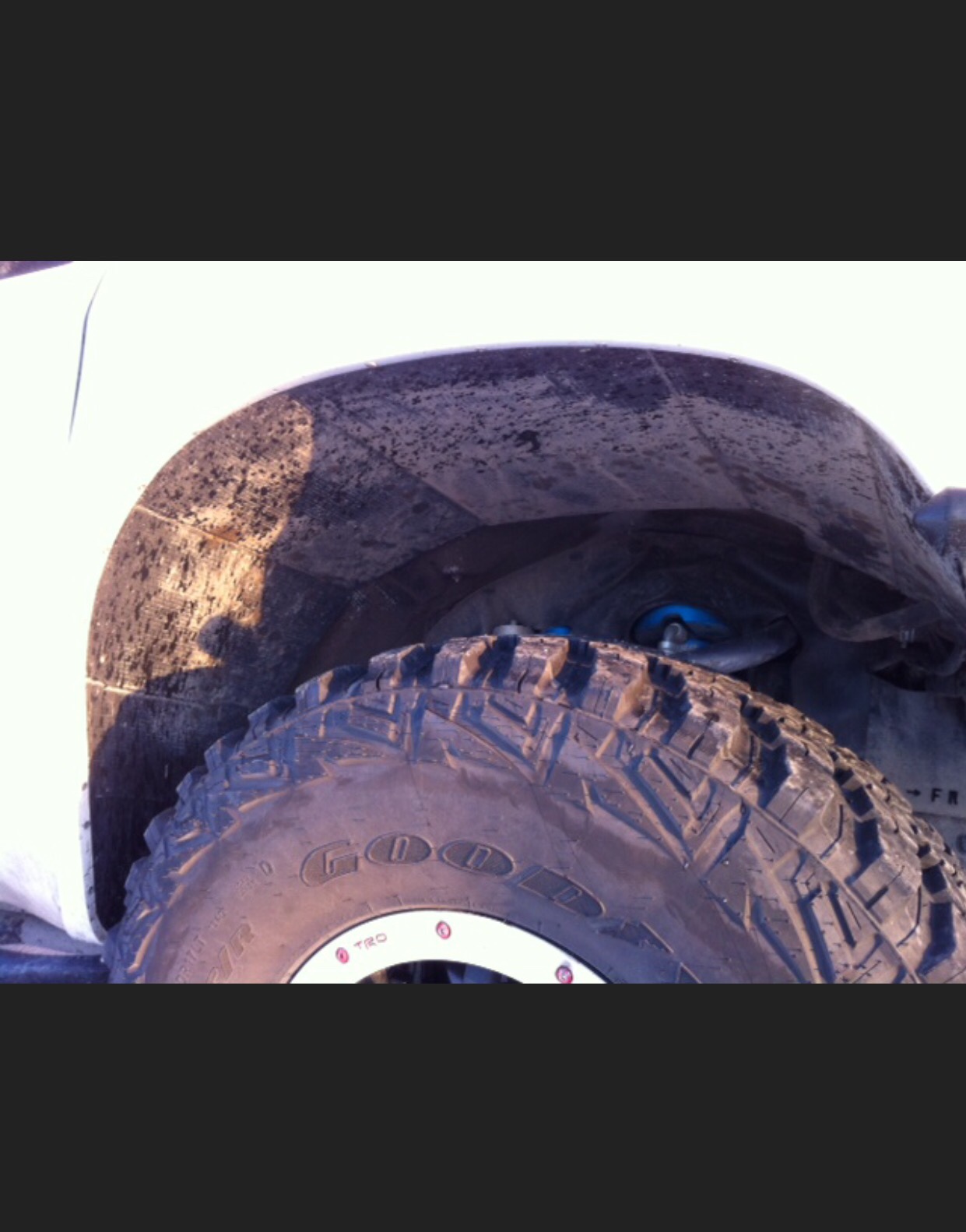

Also here is a picture of my truck with the fender liner removed. It'll give you a good idea of what you'll need to fabricate.
You can always buy plastic sheet and make the liners. Total cost is around $40. You can just rivet and use self tapers to attach them. I did this on my old f150. I will see if I have any pictures of them. Also, having the inside of the fenders sprayed with bed liner or just buying the spray on stuff and doing it yourself is a good investment.
I can imagine that would look good or protect the engine and other exposed components.
Sent from my SM-G930V using Tapatalk
Yes sir, prevents a lot of dirt/mud/rocks from getting into the engine bay and also buildup from accumulating near the fire wall.
That's one hell of a plastic sheet lol
Some people have also used mud flaps from a semi. They are roughly a 1/4" thick and fairly easy to cut.
Similar setup as my f150. 1/8" ABS plastic sheet. Plastic liner is riveted to the lip of the fender.
