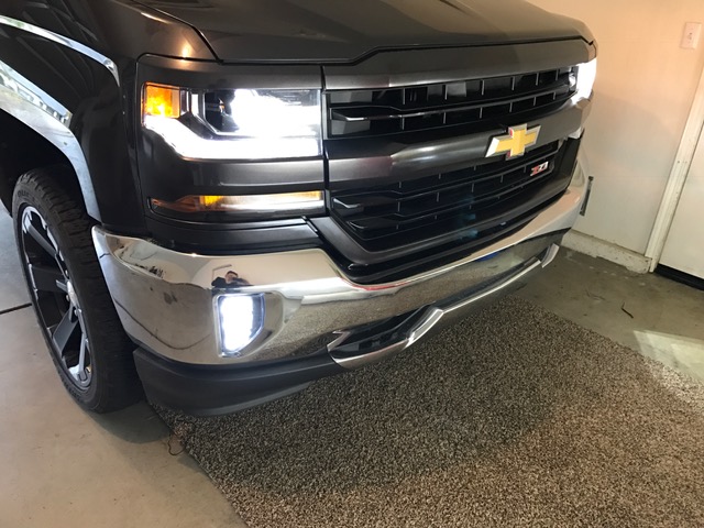

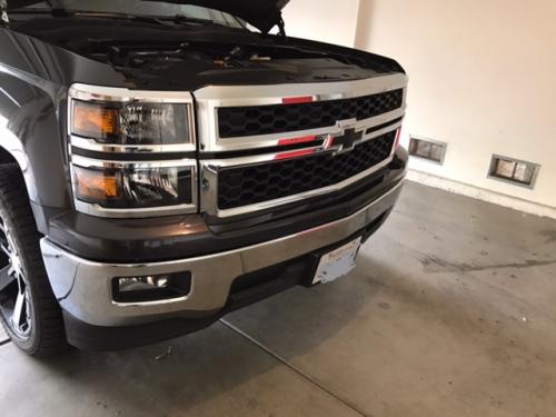

Just wanted to share my project for those who might be interested on doing the conversion. Some might think is a waste and some might actually like it. every body has there own taste and gotta respect that. My truck started as a 2015 silverado black sport edition I think that's what's called. It was wrecked and I had to replace front end so why not upgrade while at it. Here is the result.
From this
To this

Thanks ? Yeah if they have it available it will save you alot of time just by getting the harness from them. Other than the harness and the lights costing alot its a pretty easy conversion. Good luck and if you have any more question lmk Edited by Dbeto54
