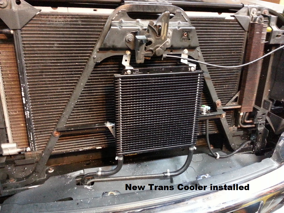

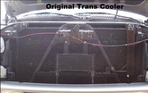

Welcome to the Forums and Grats on nailing that T case issue! Towing, I have one thing I feel Gm was lacking at when trucks were built ( for towing) Its the Trans cooler. The factory cooler is minimal at best. replacing is easy and I highly recommend it to extend Transmission life. Removing the grill is just clips are the headlight pins are pulled, and its right there, so easy.. Here is a replacement INSTALLED, over 100% more cooling , and under 50 bucks for the kit with some brackets and clamps. Next pic is a stock coolerpost-142629-0-84056300-1468600588_thumb.jpgpost-142629-0-45968600-1468600687_thumb.jpg
I like that bigger trans cooler, that would help a lot. Since you've done a lot of hauling, you probably already know this, but if you're towing something really heavy, set the transmission in 3rd gear and put it in tow/haul mode

Thanks for all of your responses so far, I appreciate it! Forumulabruce, I have read several threads about upgrading the trans cooler, and I definitely plan on doing that. It might not happen before I go to Florida, but it's going to get done sometime this year for sure. Raptordude, yep, I know about using the tow/haul mode. And actually, my last truck didn't have the tow/haul mode, so whenever I was hauling heavy I did just what you said - I just ran it in 3rd gear. R1byker, those are all some great things to know, and no need to apologize. I did know some of it, but you answered one question I always had - I never knew why some trailers ran right down the road, and some had so much sway. Now I know! I had read that you should load the heavier stuff in front of the axels, but I didn't know that it helped prevent the sway.

That trans cooler upgrade is it only for the 6.0 or can the 8.1 be up graded also? Thank for any info
Oh yeah, I have done 2 for friends on the 8.1... well worth it
Where did you find the kit and do you have part number for it thank you
I think thats a B&M cooler kit, its been in truck for 4 years but I am sure you can get a kit much bigger than stock for in that ball park
cant get a link to work on here, so go to Amazon type in B&M super cooler, found one for $79.91 but its pictured upside down from the installed position.. Works excellent! PS I took a small right angle bracket and bent it for a mount(s) could also be a slightly different size than mine ( wider and not as tall, Im not sure though)
