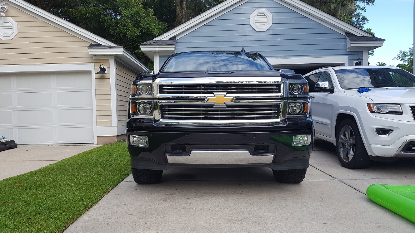

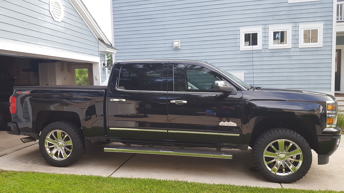

2015 Leveled w/ Bilstein 5100s and BFG 285/55R20
I pulled the trigger and put on the Bilstein 5100s at the highest level, with new Fabtech Uniball UCAs, and 285/55R20 BFGoodrich AT KO2s.
I love the look, however....

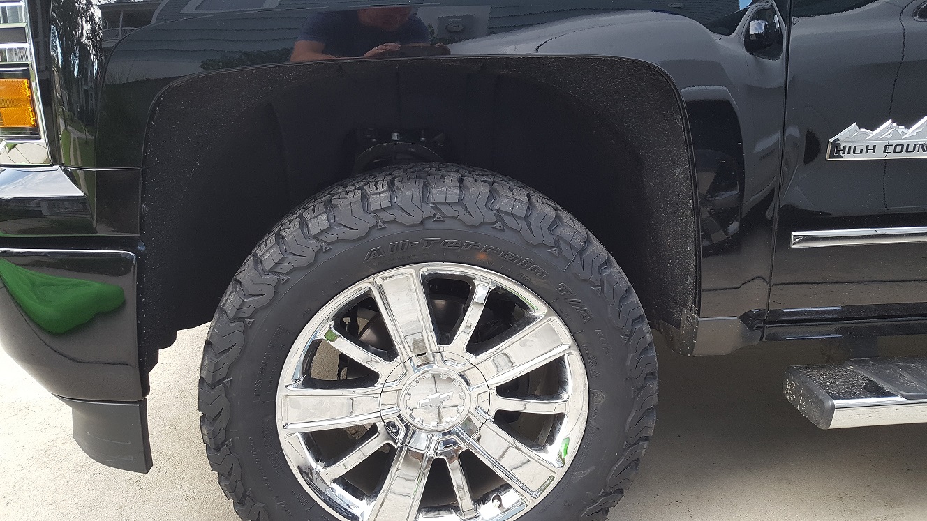

1. My tires and inner wheel rim edge are slightly rubbing the fwd edge of the new UCAs, which are much thicker and more substantial that the OEMs. I really like how the uniball upper ball joint corrects the angle, and its much beefier. So I don't really want to go back to stock UCAs.
2. I want to keep my stock Highcountry wheels. I know, I used to hate them, too. But they've grown on me.
3. I hate to say this......but....I think my only option is wheel spacers (%$%#@#@%^%^$@#!!!)
- What are the thoughts on wheel spacers? I should only need about 1/4 inch. I hate to do it, but I also don't want to blow away the $$$ i spent on the Fabtech UCAs....and I'm not buying new wheels (the wife unit would kill me)

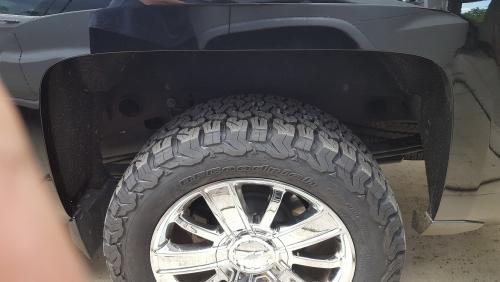

4. Finally, I may end up throwing on larger rear blocks (Rough Country 2in tapered) to bring the rear end up just a tad higher. Thoughts on those? Would I need to do another alignment?
Thanks!
I like it. Need to remove that pesky air dam though. Can hardly tell it leveled from the front with that thing on. Just my preference,

I added an extra inch of height to my rear when I added the bilstein 5100s @ all 4 corners w/ the fronts @ max, I believe they were readylift brand 2.25", and I still have a nice looking stance/rake when unladen, but less so than stock, I removed the lower front air dam which accentuates the small "lift", I have to agree that it makes a difference as my truck looks higher than yours & I'm still running stock goodyear SRA's

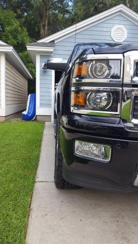

Do you have any side and straight on front end pictures of your set up? I'm still skeptical of the spacers but I'm not 100% against them yet.
