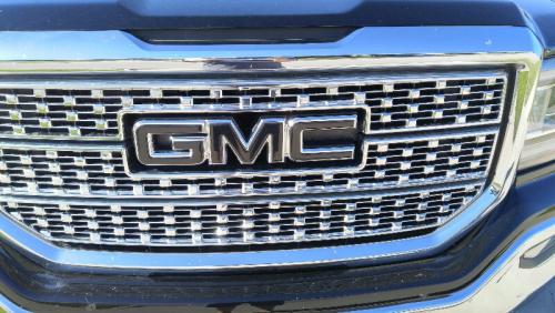

Front GMC logo
AMDftw
Looks great!! What did you use to get the glue off after removing the emblems? I did it on my '14 and fought hard with the glue and ended up using one of the 3M eraser wheels but it pitted the paint in several spots. Really want to take them off again on my '17 but don't want to go through that again. May just white out the front and back this time.

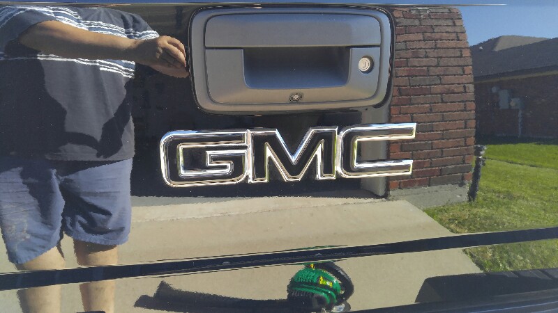

Removed my emblem, used a wood burning tool to melt the plastic rivets and removed each letter. Let the larger GMC (factory chrome) emblem sit in acid till the chrome was gone. Cleaned everything up and took it to GMC and had them color match it for me.
