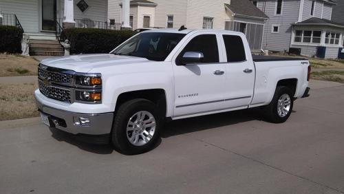

I've seen people posting that they have dropped the back of their trucks by taking the 1.25" block out.. I am curious what size or what u bolts I will need when I remove them, or can I use the same u bolts?
Please post pics after you do this. Thinking of going this route myself.
You can reuse the stock u-bolts, you will need 16 thick washers per side to take up the space from the block being removed. That is all I did on mine.
Here is a pic of mine after removing block. It sits just slightly higher in the rear.
Sent from my Nexus 6P using Tapatalk
I did shackles on my 2014 and hated how the truck rode afterwards. They change the spring rate to some degree and made the truck more prone to bottoming out when hitting hard dips in the rear end. I removed the lowering blocks on my 2016 and it rides perfectly fine.
Cool. I haven't noticed anything yet, handles fine.Only a thousand miles. And I live in the burbs so no big bumps or dirt roads. Plus I really don't know stock, dealer leveled for me.
