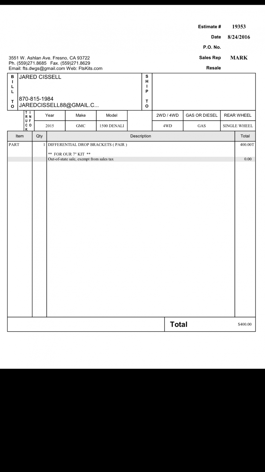

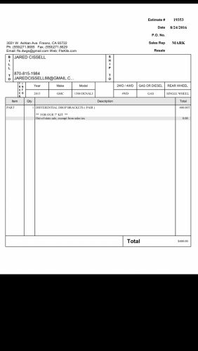

Just got off the phone w fts they will sell the diff drop and bolts for around 400 I'll let you guys know how it works with the rc kit. I'll have to modify or remove the skid plate most likely. They also said I could use the stock driveshaft

They called back this morning and after talking with their techs it won't work. The fts diff drop is closer to 8". The drops on the rc kit is 5.75 ish.
I'm gonna make some 3/4" spacers to just get the angle liveable. I can feel the vibration in my steering wheel when I'm in 4wd.
