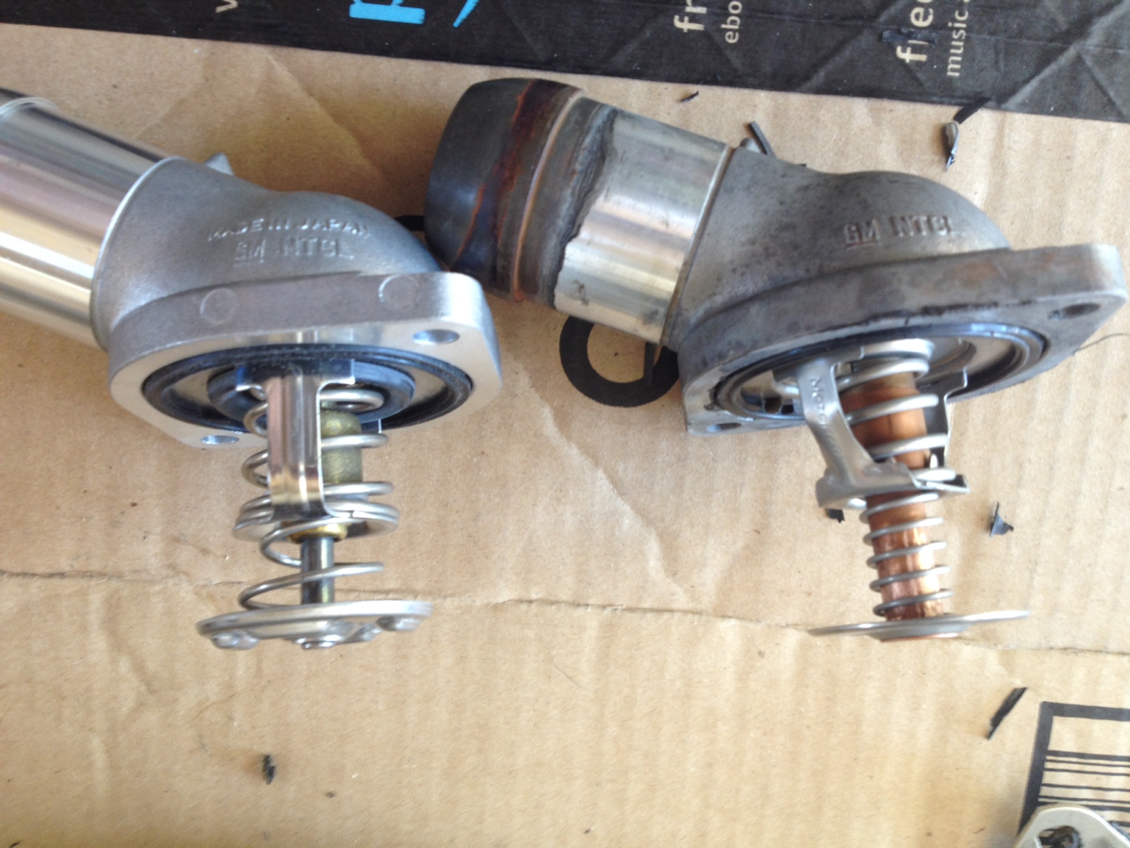

following up on this. I thoroughly flushed the entire system, then flushed each part of the cooling system individually, engine block (including removing driver side drain plug), heater core, and radiator, reservoir tank, etc. and replaced the water pump, tstat, and radiator with all oem parts, that seems to have fixed the overheating problem when hauling the camper. i suspect the t-stat (both of them) were incorrectly sourced or they simply were not up to oem spec. i think it was not opening up enough, that with a radiator which was not dimensionally adequate and up to oem specs. my temp gauge doesn't move now up or down the grades like before whereas the replacement t-state would allow the truck to cool down to 180-185 on the long down grades.
i was quite surprised in the difference in construction between the oem and non oem t-stat, see attached pic. the oem t-stat is on the left. lessoned learned, don't neglect cooling system, use oem parts, and when you want it done right do it your self!
Glad you got the problem figured out, but dang! It's a chunk of change to get a factory T stat, waterpump, and radiator! Oh well, smooth sailing ahead
