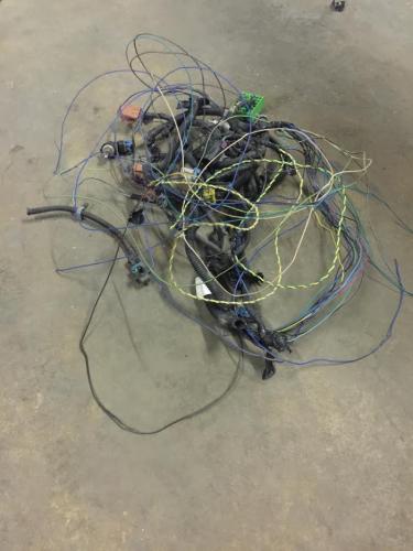

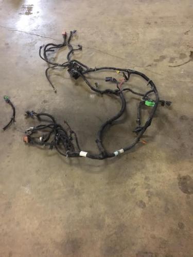

Find the harness out of the donor car and cut the fan control out of the harness with the fuse box. All plugs and plays. IF the engine harness is still in place remove the connector and pins from the pcm for a seamless install. Im actualizing doing two harnesses today for a 04 denali and one for an 02 silv2500. I will post pics of how I do it later.

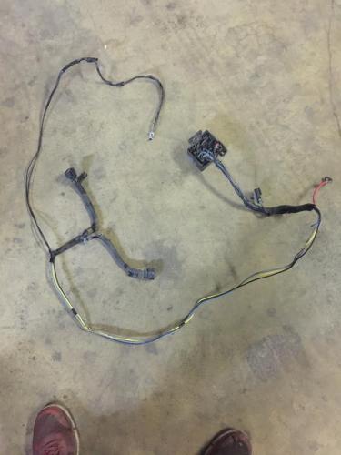

Stripped the front light harness off the fan relay and harness. The one two socket plug has the high and low speed fan control that goes to the pcm. I will post more pics later.
