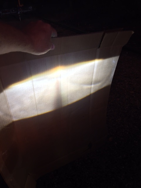

1st pic is the reflection on a piece of cardboard about a foot in front of light. You can see the shadow of the "electrode" on the HID light.

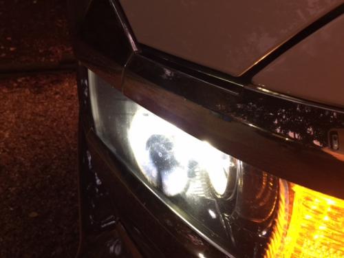

2nd pic is what the light look like while looking at the lens of the headlight assembly.

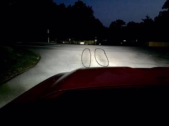

3rd pic are the shadows circled on the road. It worse in person though.

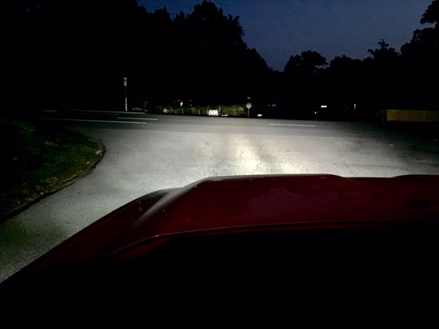

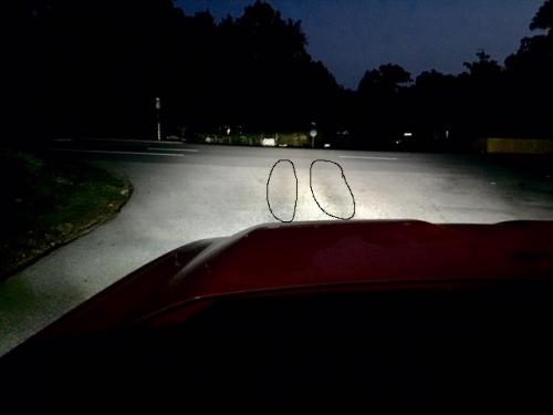

4th pic are shadows without being circled.

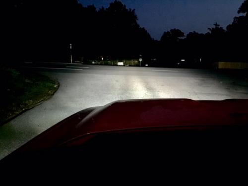

If I have this line at all it's up, not down on mine.
I did not do anything special to install mine, they are in just as intended. However they are side specific left vs. right, so if your shop installed them backwards this could be why you're having an issue.
Here's a pic of mine. You can kind of see that same line at the top of the 1st image.
